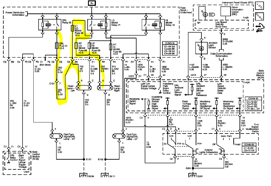

There is a curious bit of wiring in the headlight circuitry. Note the way the DRL is wired into the left lo beam then through the right lo beam fuse to the right side.
Attachment 45797
Attachment 45797
OP's problem is the left though. It may be that unlocking the car turns on the high beams, which both bulbs are good. Then starting the car turns to low beams, and one bulb is bad, or the left low beam fuse is bad.
And the rear marker is on when the headlights are on, but off when the DRLs are on, which is correct operation.
