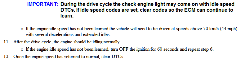

I'm confused where the title says "Without Scan Tool" but step 6 says "with a scan tool"
What if desired vs actual RPM are not with in limits ?
Do the relearn over ?
Asking to learn, not to be a PITA.

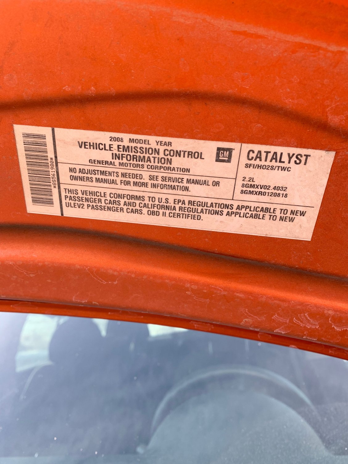

Update. Here is a better picture of the catalyst label
I started the vehicle and had no ‘eng pwr reduced’ display this morning.
I drove it to Auto zone to check the battery. They said it was a bad battery. We purchased a new one. The code reader gave us the same codes.
I took it to Pep Boys for a readout but they said the person who does it was not available. I drove it home and noticed that it had little power and I pulled over and turned it off and started it again. It ran fine for about 40 miles without any issues.
The car also has a static shock whenever you touch the outer surface.

Originally Posted by Cat Man HHR
Thanks Don
This is why I sent you the manual..
You can do it wuith a scan tool, the difference is you monitor live data.
If for some reason it does not settle down you go drive it at over 45 MPH for a couple of minutes.
here is the IF portion of the procedure
