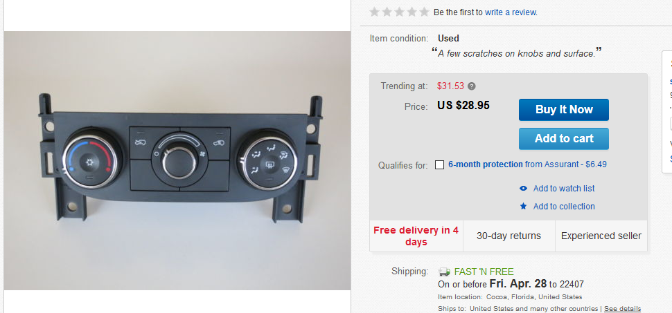

Posts: 26,532
Could be the button/control module then.
Like this used one:
Old Apr 24, 2017 | 08:28 AM
tjustice's Avatar
Joined: 06-14-2015
Posts: 13
From: arizona
Thanks very much. terry

Problem solved, was nob on left [push button] thanks for help.
Old May 15, 2017 | 06:43 AM
Posts: 40,082
How do? Not pushed to activate the A/C? Or not turned to the left to coldest setting?
Old May 15, 2017 | 08:27 AM
tjustice's Avatar
Joined: 06-14-2015
Posts: 13
From: arizona
REPLACED was not activating outside air, worked fine in OCTOBER, wouldn't work on some 90deg. days we had in march , crazy about my HHR. terry
