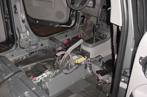

First off I would like to thank those who answered my question about my airbag removal. I have replaced the seatbelts and drivers airbag...the "service airbag" appears and airbag light is on...where is the airbag control module located in my 08 LS Panel ?

Under the console the yellow piece in front of the e brake

After it is replaced it needs to be programmed.
