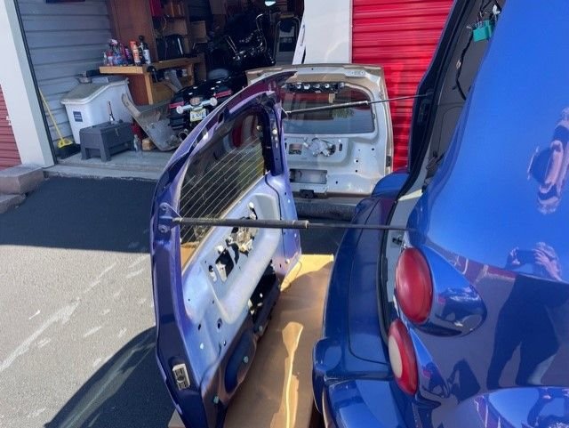

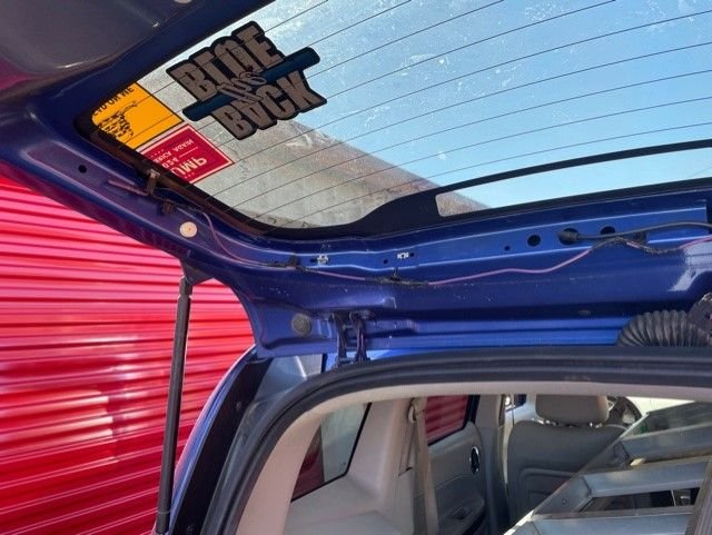

Where is the connectors to replace the electric/water? I pulled the top of the connector and didn't see it there- is it in the body?
Old Sep 3, 2021 | 06:31 PM
Lonwane's Avatar
Joined: 03-12-2017
Posts: 1,250
From: Phoenix
The washer line is in the roof and the electrical is behind the panel on the hatch door.

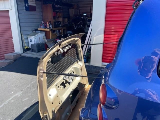

Well thanks for your help! It all went real easy, I figured out an easy way to replace the back door. (I'll be painting it someday)
