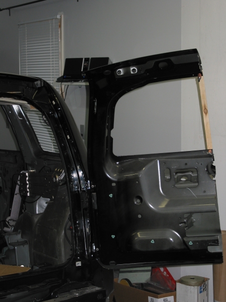

From what I see in the picture that is in the Gallery from way back when, you cut the original hatch down the middle, right? Maybe you or one of the members that know how to post pictures could post the one in the gallery to this thread so everyone can see what you are dealing with. Sure hope to see the completion soon. This is one thing I wished Chevy did, I just don't understand why they did what they did. The barn door or even a split hatch like the old station wagons would of been nice.
Here ya go.......
