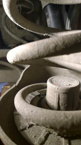

thanks for comments on my coil spring issue. yes its same 2008, mexican built 2.4 automatic HHR LT, with stability controls and 4wheel abs, but rear drum brakes.
all stock. added pic of broken spring to my gallery.
...so i ordered stock moog (cheapest!) rear coilsprings. quite cheap considering my local vendor said pair is 155euros (=195USD!).
MOOG CC81063 Coil Spring (8708.80.9100) € 23.41
Old Oct 23, 2014 | 10:05 AM
  #43
Posts: 11,721
Is this the broken spring ? Maybe I'm looking at it wrong, but where's the broken part of it ?
Name:  broken spring.jpg

Posts: 96
From: finland, europe
yes, its at bottom of the spring. look closely

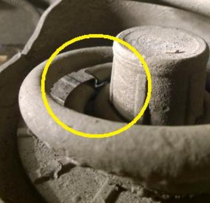

Old Oct 24, 2014 | 06:54 AM
  #45
Posts: 11,721
OK. Now I see it.

Old Oct 25, 2014 | 01:26 PM
  #46
Posts: 40,083
Yup that's a noise maker! Nice deal on the replacements!
