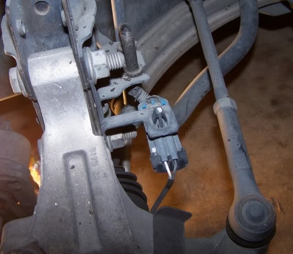

I was looking for proof my 06 LT had abs by checking the build codes that are supposed to be in the glove compartment (JM4). Unfortunately, there's no tag (maybe the glove box was replaced by a PO?). Anyhow, is there any other way to verify this? I can only verify that all the abs fuses are in place in the underhood fuse block.

i found in this thread that chevymgr confirmed JM4 is the code
https://www.chevyhhr.net/forums/general-hhr-4/anyone-know-what-3-character-code-abs-brakes-13748/
but another idea would be to slam on the brakes? (dangerous i know)
or look for the wires and sensor on the back side of the wheel hub

the wires and sensor here

Thanks Bill, I'll check that out as soon as the rain stops. I'm betting on false info from the dealer we bought it from (sticker said it had abs and TC, but recently noticed no abs light on start). With no sticker in the glove box, couldn't crosscheck myself.

It stopped raining long enough for me to poke my head inside the wheel well and take a look for that sensor/connector. No go, it doesn't have ABS, as I suspected.
