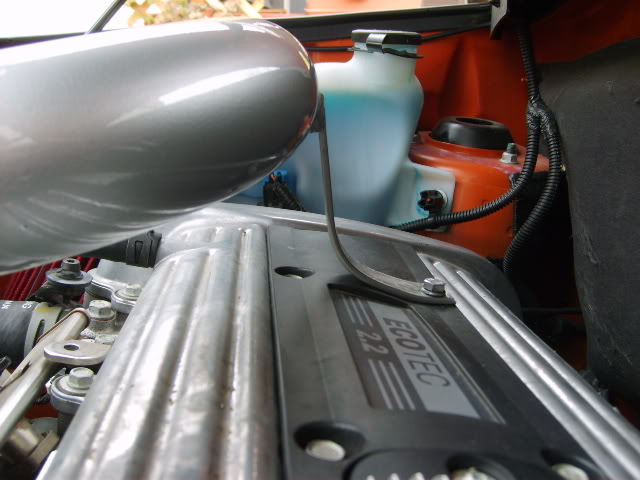

I've got the painted CGS...but I bought mine before the ceramic one was available. But that's ok...mine had to be modified to fit my 2.2L engine originally and I modified it a bit more today so it wasn't rubbing against the hood strut. Tomorrow it's coming back off and being sanded and painted Sunburst Orange Metallic.
Deb,
How did you modify it to stop rubbing on the prop rod? I just installed mine two weeks ago and already the paint is rubbed off the intake from the prop rod.

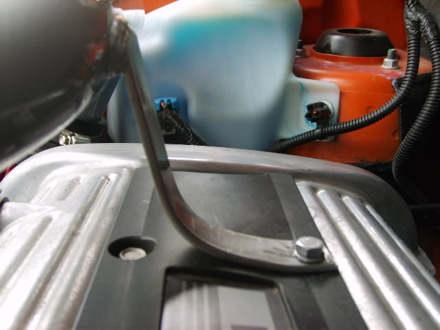

Ok folks...here's a quick how to on what I did to mine.
First time around I had to bend the support arm and drill another hole to adapt it for the 2.2L. You will need a 6 X 50mm bolt with 1" pitch and a flat washer which you can buy at Ace Hardware for a buck or two. Without the modifications below, I had a rub like thedonn07 did.
I was talking to CJ on instant messenger the other night and asked him what he had done when he modified his so it wouldn't. I followed his information and it now lays back better and doesn't rub any more either.
The modified length of the CGS support arm on mine is around 5 1/4" from the top weld to the tip end by where the bolt goes into the head. I measured down approximately 2 1/4" from the top and put a new bend in the arm as you will see in the photos below. Then once I was happy with that bend, I marked it so I could cut off the part that overlapped over the head and cut that off with a hacksaw. I then marked where the new bolt hole had to be drilled a new hole for that.
I didn't have a vice to bend it with, so I pulled out my boyfriends hydraulic jack and put the arm in between the metal pieces and carefully bent it where I had marked it. Crude...yes, but effective.
Here's the photos I just took so you can get an idea of what it looks like. Hope this helps the 2.2L owners. Guess maybe I should put this in the how to section. Not professionally done, but a girl has got to do what a girl has to do. Another mod done by little ole me.
