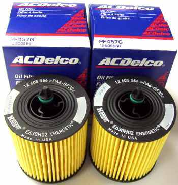

Just to clear up the Hengst question:

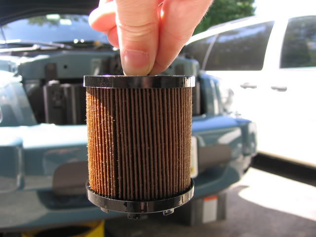

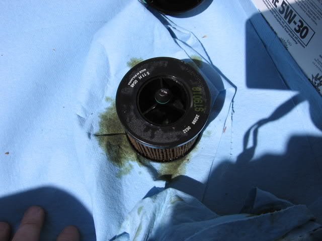

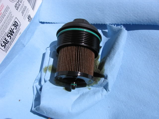

Ok changed my oil today..3000 mile change per my plan as stated above....here are some pics of the Super Tech 9018 filter that was used...look at how much tighter the pleats are on the filter vs the OEM filter...also notice how the filter is not deformed like the OEM and this was after 3000 miles...the Supertech 9018 and the Fram 9018 and also the STP 9018 are all Made in Bulgaria and appear to be exactly the same except the media in the Fram is a bit darker. There is a Fram 9018 in for a filter and the fill is Castrol GTX 5W30. May go to synth next change but I have a lot of dino in my garage.
