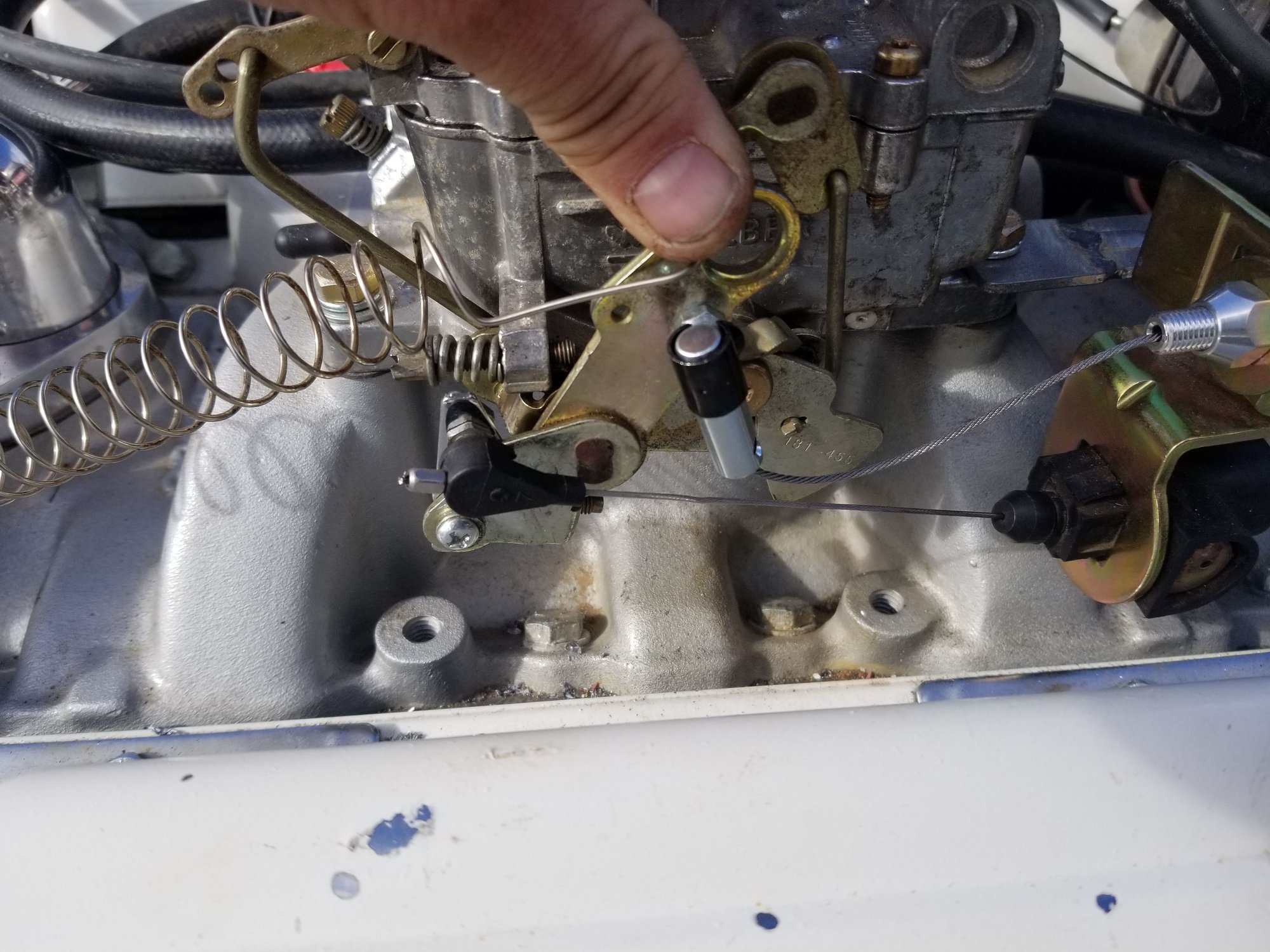

Originally Posted by RattyHHR
Thanks for looking out Cat. Its one of those optical illusions I believe. Right there at the end of the cable where it attaches to the carb there is a slight dent in the cable that makes it look like its loose. The throttle linkage doesnt move at all without pulling the tv cable. When the carb is at wide open throttle, the cable is pulled all the way out. And when the carb is at idle, there i no tension on the cable. This is correct right?
The TV cable should have tension on it at idle and full throttle with no excess cable movement. You could drop the pan and go to full throttle to see how much movement is left on the TV valve also. The valve should also be bottomed out.

You adjust the TV cable at the carb
Art Carr's 700r4 tv cable adjustment guide from CPTtransmission.com

Originally Posted by Oldblue
That is correct Mr Blue, but not having the correct geometry for that will cause problems with the trans. He is now using an Edelbrock carb and should have this on it.
Buying the correct throttle cable bracket for this carb will greatly improve the adjustment also.
It sure will, I just didn’t want Ratty to think he had to drop the pan!
Dropping the pan and checking the throttle valve itself will prove (if need be) that the cable is adjusted properly at full throttle only. By the drawing it has to go thru the 78* swing arc for the trans to shift correctly.
Look at the picture he has and you will see, compared to what I show, is in the wrong starting point for the cable.

I did a lot of research into the tv cable. Thank you all for the information. As y'all suspected, it was put of adjustment. I used a valve cover tab to make a bracket to correct my angle and give me complete pull. Thanks again for the help!!
