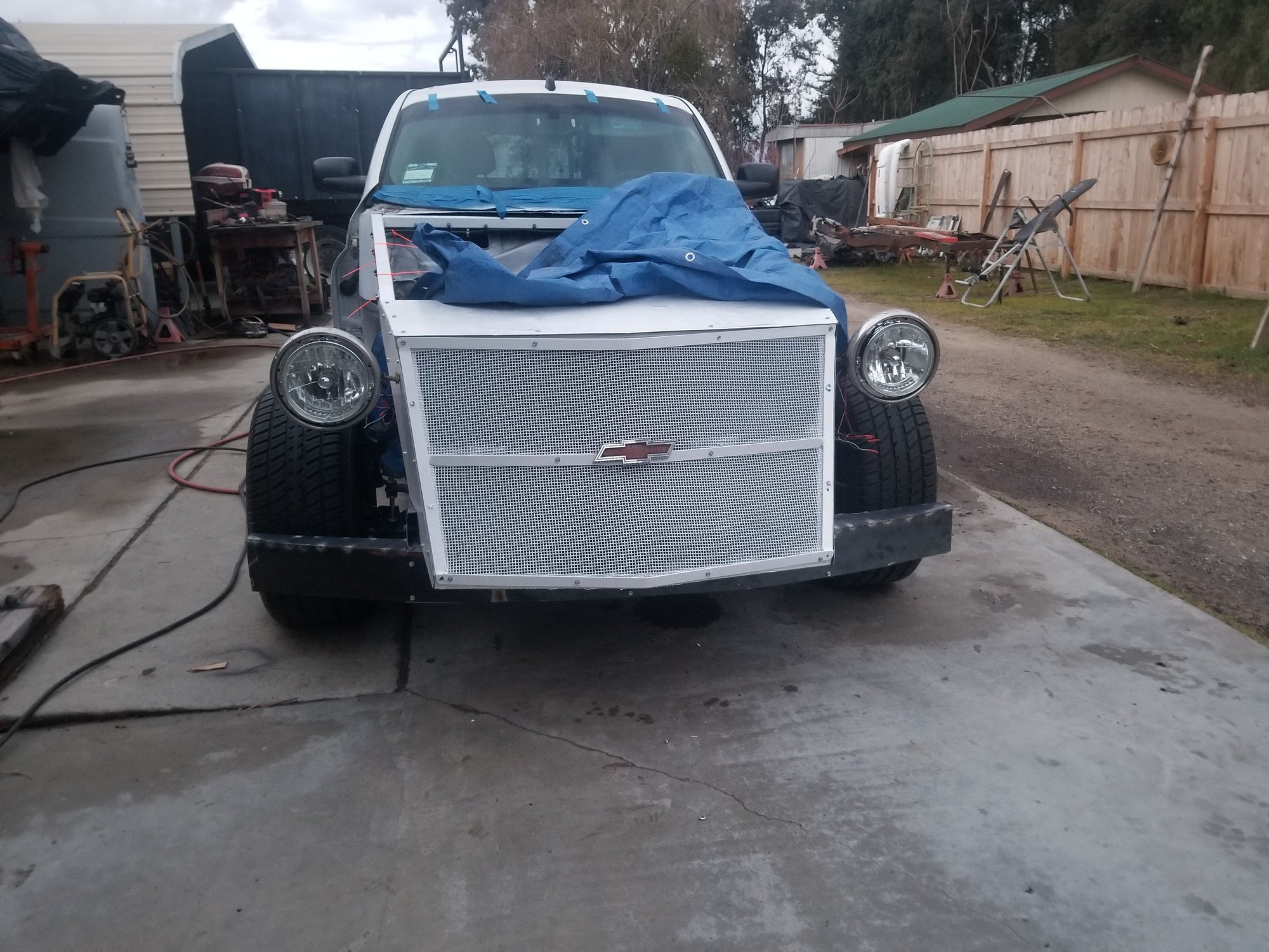

Ratty I agree with you. The round lights conflict with the squareness of the grill. Blending them in will help.

Sorry Cat, the headlights are really bright, the LED marker light / blinkers seem very dim to me. Must just be me. Thinking back, i had the answer the whole time. LED bulb for the moonshine jug would only light up when inserted one way. When reversed it didnt work

It quit raining long enough for me to get some bumper pieces tacked together. I think it's gonna help make the headlights look a little less space.

Ratty, what if you move the head light down towards the bumper? They make pillar stands that you could use also.
Here's an idea:
