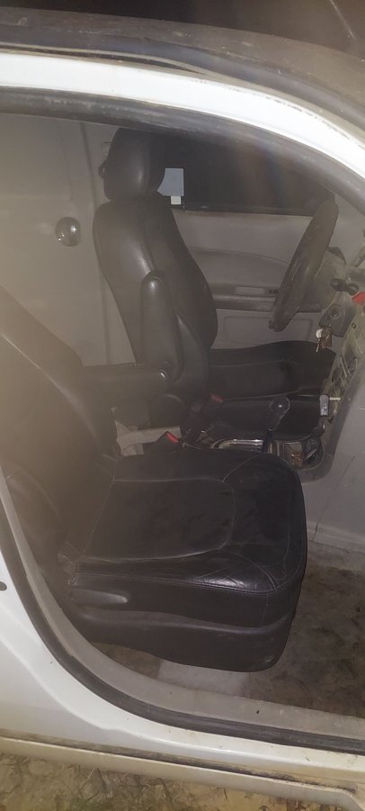

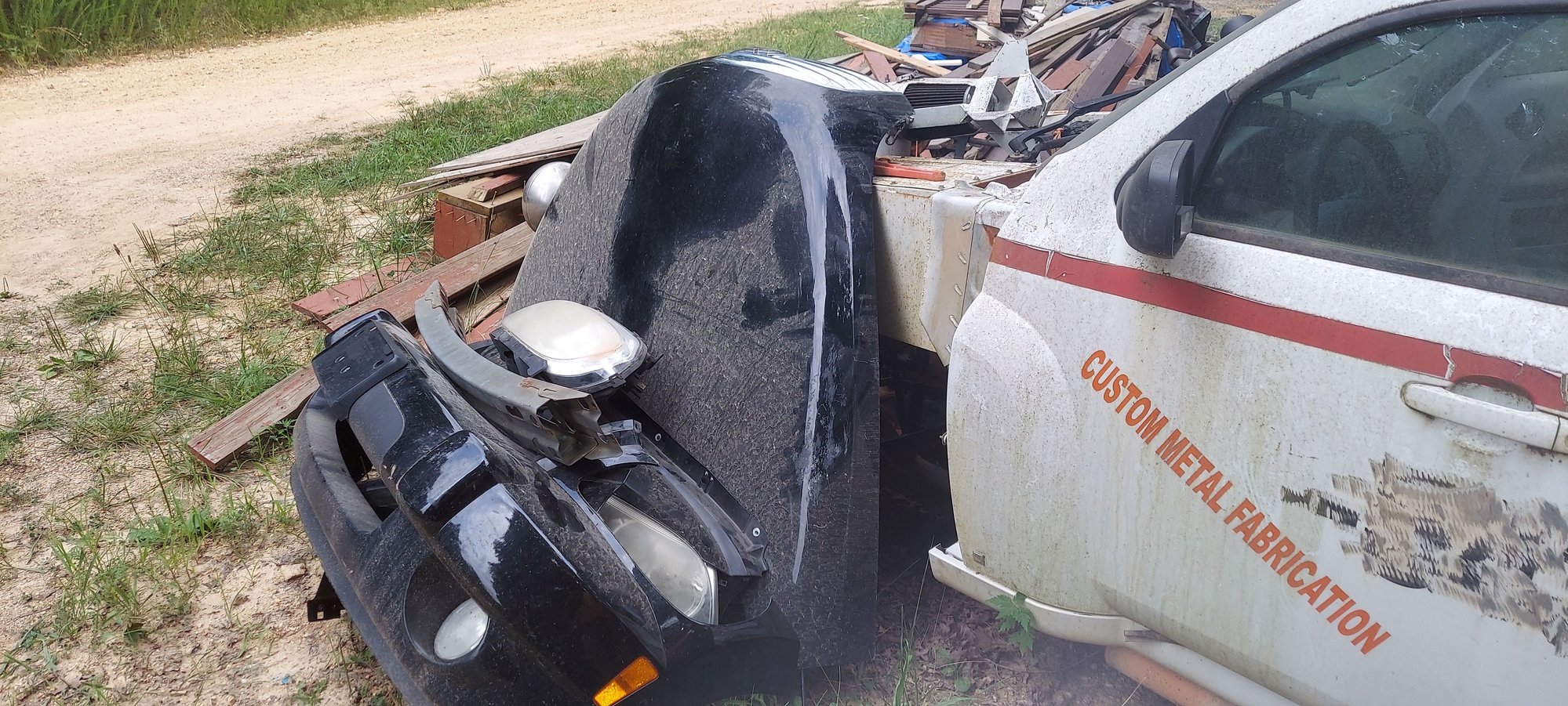

I have a buddy who scraps vehicles, and he finally had an HHR roll through. A nice one to boot!! Nice black leather interior, body panels in good shape, so I went to town. I got the hood/grill, front bumper cover, fenders, and rear hatch from the exterior. Inside I picked up the front leather seats, door panels, console, black carpet, and every trim panel I could get off. I've always been a fan of black interior, and this stuff is in great shape, so I'm excited about that.
The plan for the front end is to remove the big square grill and shroud that I fabbed up. Probably going to cut the upper tubing going from the firewall to the frame. I grabbed the metal bumper that is behind the bumper cover from the donor HHR. Inside the cover, is a foam piece that is formed to fit around the metal bumper. So that metal bumper is gonna be the foundation for the bumper cover. I'll get it place, and weld it up, then run small braces around the cover to make it nice and solid. I'm only planning on using the front 12", and rear 18" of the hood. The front will cover my radiator, and the rear will cover the junk on the firewall, and tie into the shortened fender pieces. Basically the engine will still be open/visible, but the front should blend much better with the rest of the car.
Front End Upgrade
New Seats
Hope everyone is doing well after the crazy last couple of years!!
