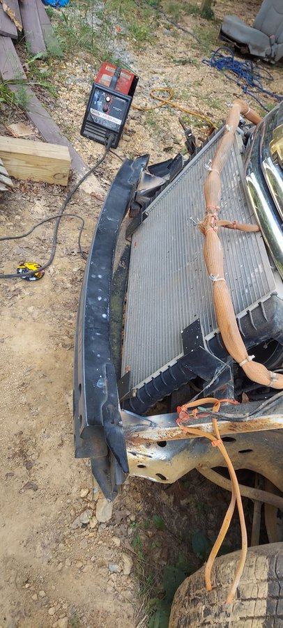

Made some progress the last couple of days. The Indy car race was here in Nashville yesterday, went to a buddy's place to watch it. Back at it today. Yesterday I pressure washed everything. Beatrice sits out in the weather year round, and there was plenty of evidence Also got the steel bumper welded to the frame with some 1/4" flat plate wedges. Bumper cover uses 4 bolts, through to the metal bumper. Since I cut so much off the ends, it has good rigidity being mounted to the bumper.
Got everything taped off, and went to town with the flat black.
I think its a big improvement!! The flat black should help hide things like that big ass ugly box Haven't taken any pictures, but I was able to bolt the "cowl" back into its original places, with the hood hinges. Only the back holes were available, I'll figure something out for the front if I find its necessary. The front of the cowl will have a steel support off the square tubing. Im gonna find some thing guage steel, and weld a piece at 90* along the front of the hood. I'll use this lip for supports and a latch. Break is over, hope everyone is having as good a Monday as one can have.

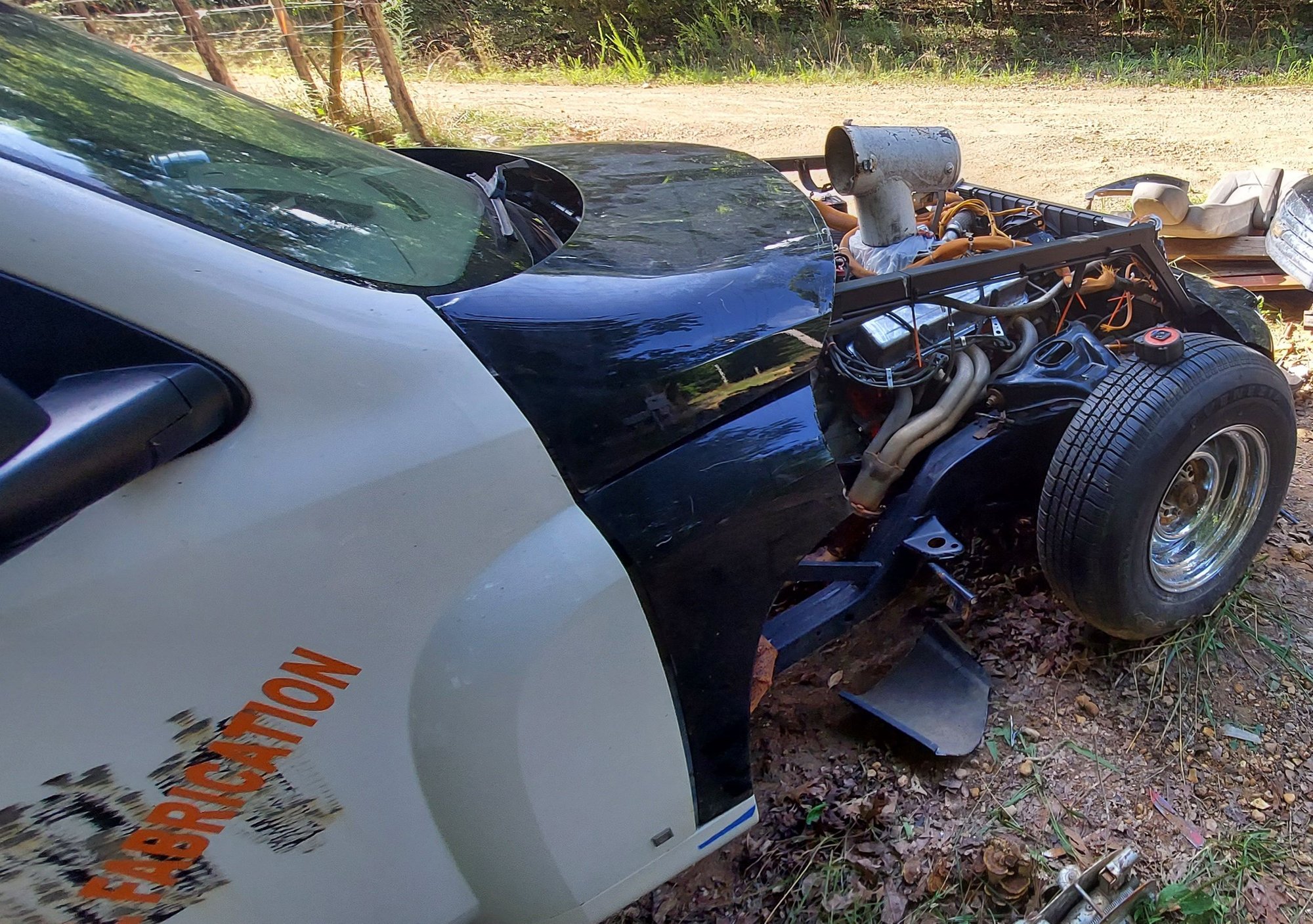

Cowl and fenders are cut and mounted

Got everything hacked and mounted
