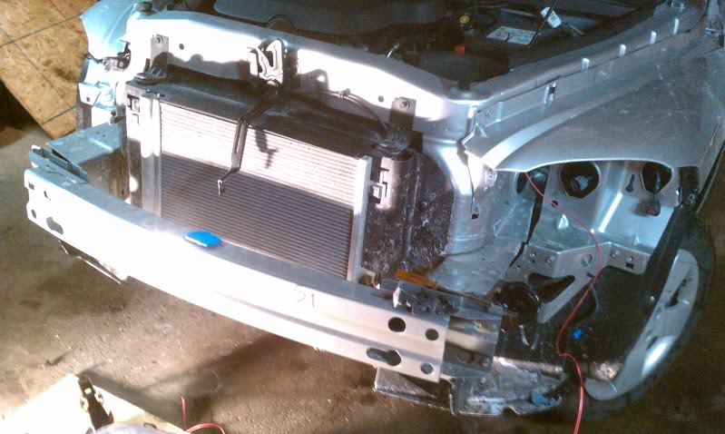

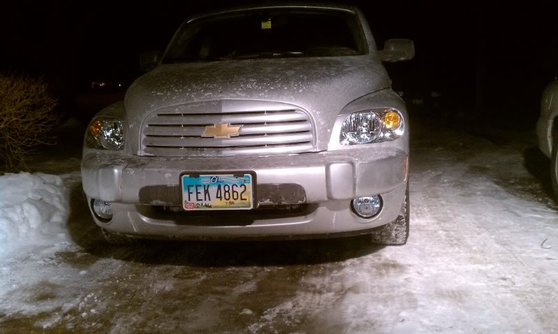

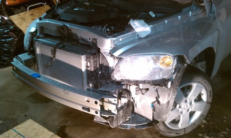

Well, I took the plunge and installed the fogs. Here she be.
With headlights.

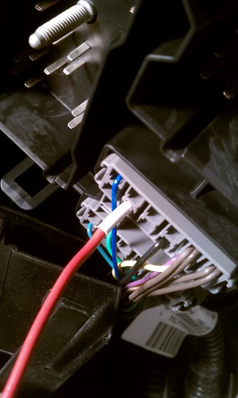

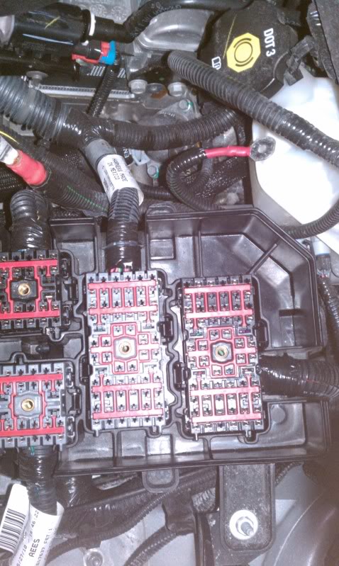

Here is the wire I added to the fuse box. It runs up to the positive leads on the fogs. I checked it with an Ohmmeter.
It is correctly wired as far as I can tell-haha.

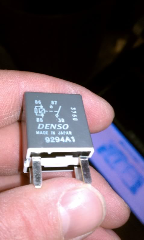

This is the relay I installed.
