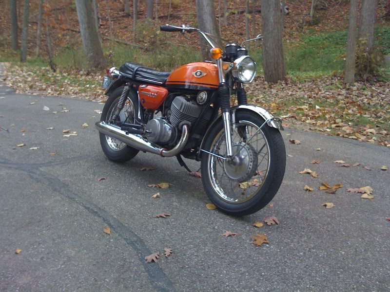

You have a GS550? Nice.
I have a 1969 T500 Titan MkIII
And a 2001 Ducati 996.

Nice toys!
