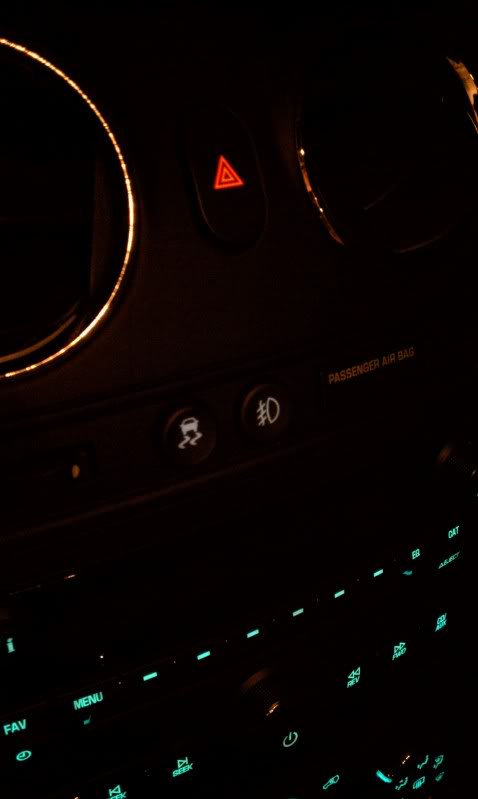

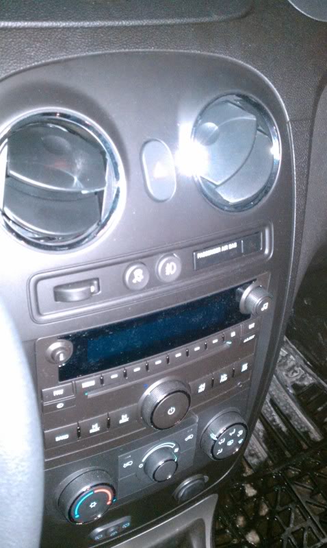

Originally Posted by ufvj217
What does the switch look like?
Like this.

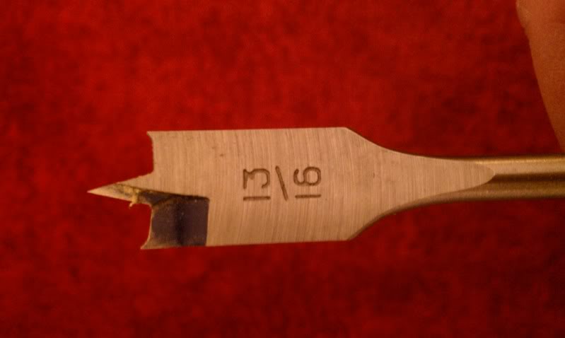

You need a spade bit like this one to make the perfect hole.

I still have to run a wire from the BCM to the engine bay power distribution center... gotta figure that out next.
