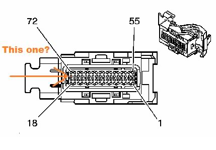

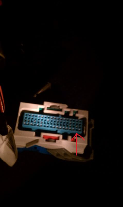

Installed OEM fogs on 2010 HHR LS-pics and questions.
Incorrect
[QUOTE=nacademus;532232]
Goes to THIS pin.
Correct?/QUOTE]
That is not pin 54!!!
This is an 18 X 4 row connector. Three times 18 is 54, thus pin 54 has to be at an end.
A check of my FSM reveals the first pin on the left second row down is pin 54.
72 -------- 55
54 -------- 37
36 -------- 19
18 -------- 01
Goes to THIS pin.
Correct?/QUOTE]
72 -------- 55
54 -------- 37
36 -------- 19
18 -------- 01

OK. I wired up pin 54 on my BCM and tested it with the voltmeter. It is always 12V, whether the key is on or off. Is this correct?
I am afraid to continue wiring it up in the event that this is wrong and I short it out
Can someone verify that pic 54 on a 2010 LS BCM is the same as all of the other models?
I even toggled the switch on and off inside with the key on. There was no variation in the voltage shown on the lead plugged into pin 54 on the C1 BCM connector.
SOMEONE HELP ME!
SOMEONE HELP ME!
SOMEONE HELP ME!
SOMEONE HELP ME!
A few thoughts:
What type of meter are you using? Analog or digital. With a modern digital meter with high impedance input the meter may be measuring some leakage voltage from the BCM circuit. Many modern “relays” are not true relays, they are semiconductor switches and they leak.
I sourced a 2006 BCM, which I took apart for another project and I only find 4 true relays within. According to my past research three are used for the door lock-unlock functions and the other is for the interior lights. This agrees with my 2009 FSM. You will have to guess as to the 2010.
For the actual problem you are having at this point; as I said above it could just be a measurement problem or there is a permanent ground on the control circuitry, i.e. Pin 16 of connector #2 on the BCM.
The schematic in post #32 I believe is from a 2006, the only change in my 2009 FSM is how they call out the connectors. In the 2006 they are a “C”, in my 2009 it is now an “X”.
Referring to the schematic in post #32 do you have the underhood wiring to the lamps done yet? I ask because I would go about this a bit differently at this point due to the confusion. Finish the wiring to the lamps from the underhood fuse box sans the connection between the fuse block and the BCM. Then test out your work by supplying a fused 12VDC source to the connector #2 terminal C1. If the fog lights come on that section all works. I like to work in sections proving what I have done is correct.
