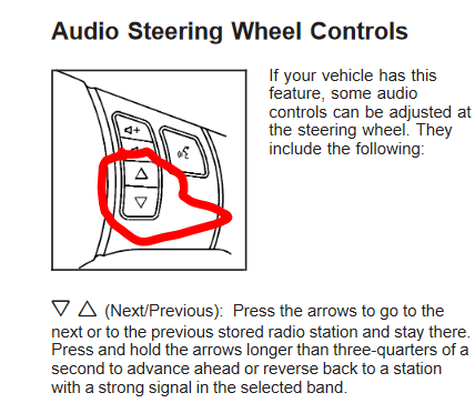

Thanks, the only problem is that we don't have the 1-6 button that the C6 does. Instead the SS has the mute button but I will give it a shot and see.
Old Aug 25, 2016 | 12:23 PM
Posts: 26,485
ch up/ch down isn't the same? How do you change presets on the steering wheel? Just pretend the up is marked 6 and the down is marked 1. Or, vice-versa.

No dice, it only scrolls through my radio presets and none of them are any XM stations.
