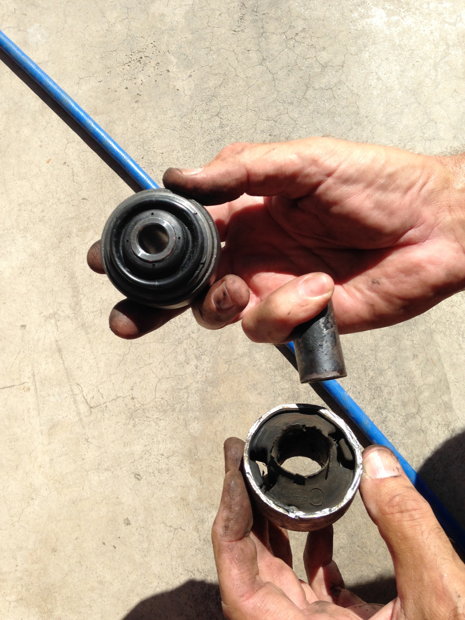

The lower control arms usually only need the rear bushing, but the front one is available. You actually save on labor by getting the assembly that includes both bushings and the ball joint.

Rear LCA bushings, Moog K200792, ball joints Moog K80567, front bushing Moog K200361 ( but rarely needs replacing)

Not many people ever look at the LCA bushing, or know what to look at. 80% chance yours are bad along with sway bar bushings and links.
