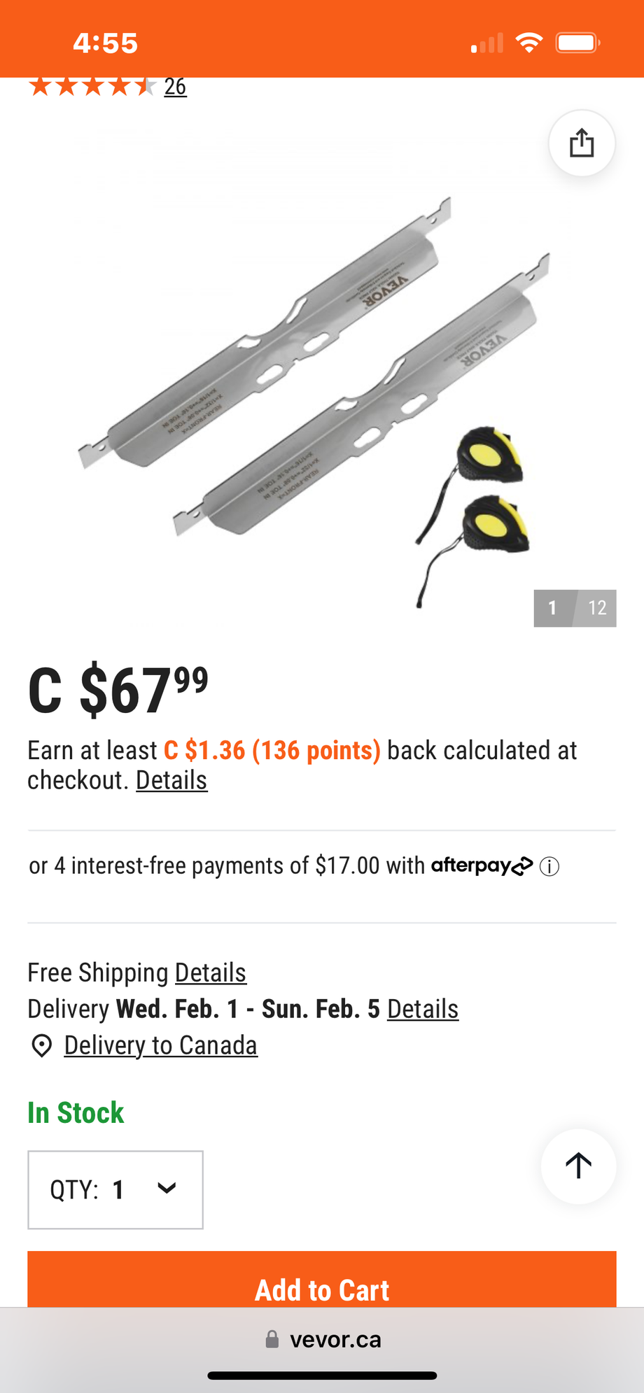

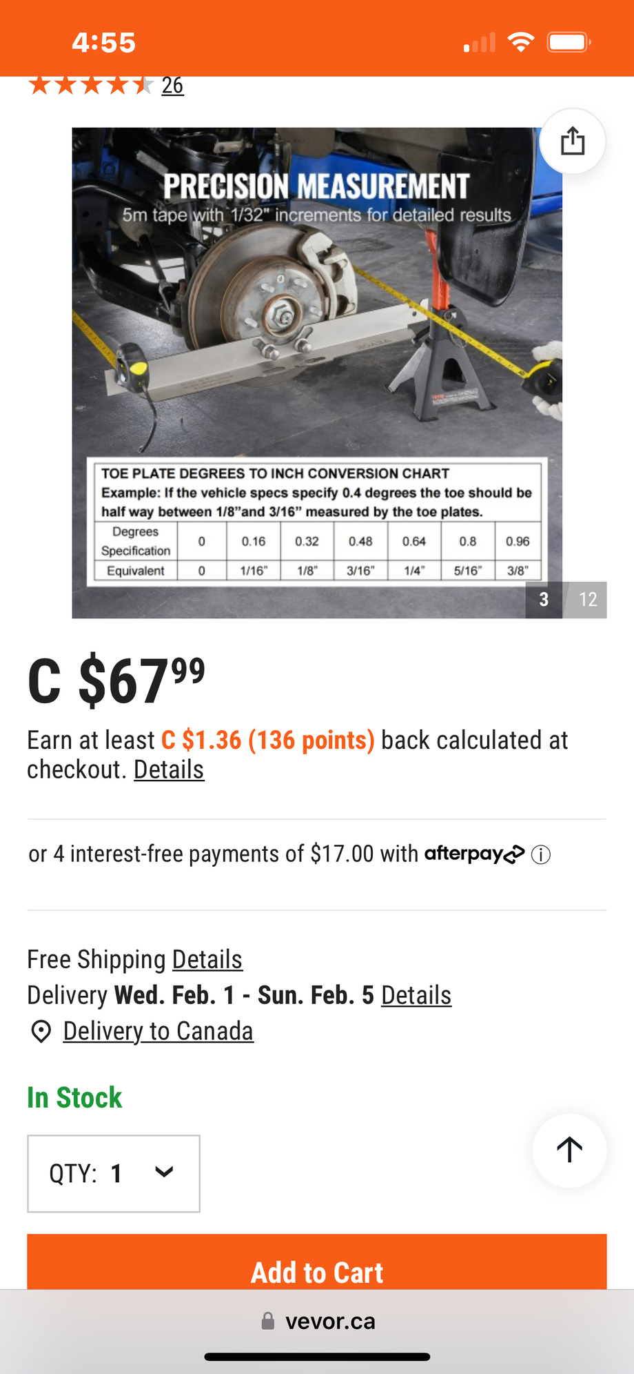

I learned front end alignment techniques with one of these bars back in the late sixties 1/8 inch total toe was pretty much standard on cars then
These plates are easy to use to get close enough to perfect
You measure and adjust with the wheels off the car, I would put the jack stand under the suspension to compress the springs, in this photo they are working on a Jeep but still appears to be IFS They use these plates in NASCAR and I would use these on my Dirt modified cars

that I would trust to be reasonably accurate, better than using the tire tread. could even get by with a homemade version I bet
