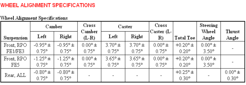

To end debate:
Old Jan 29, 2024 | 09:10 AM
Posts: 40,083
Thank you, Donbrew +0.20 degrees positive toe total .

+.20 degrees total toe works out to about .09" less between the centers of the front of the two tires than the back. I would like to be on the low side without getting too close to zero.
Don't trust the tire treads to be perfect; do a bunch of averaging. It's easier to be precise by measuring at the inside of the rim edges. There, the difference for 17" rims is about .062 or 1/16". And you need to fudge these numbers a bit of course because you may not quite be able to get to the horizontal centerline, i.e., the most forward and rearward points on the wheel. (Text in italics edited for clarity.)
