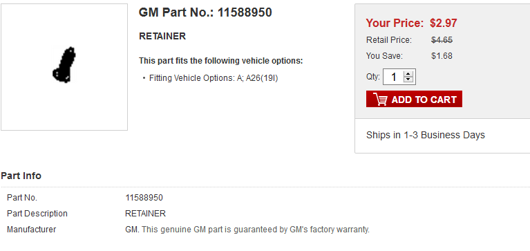

That appears to be the wrong pin. I remember that the "fins" go all the way to the head.
The one at the apex of the wheel well should be a screw, IIRC.
Like this:

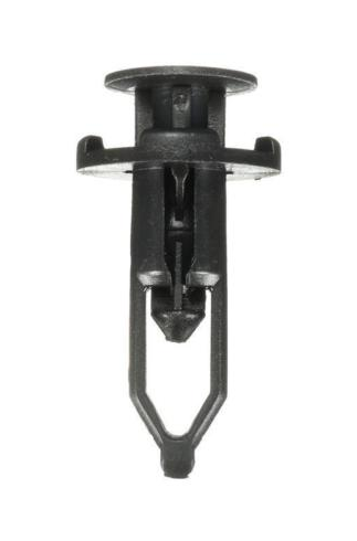

Here is the other kind: 30pcs for Chrysler GM Push Type Hood Coolant Recovery Retainer Fastener Pin | eBay
