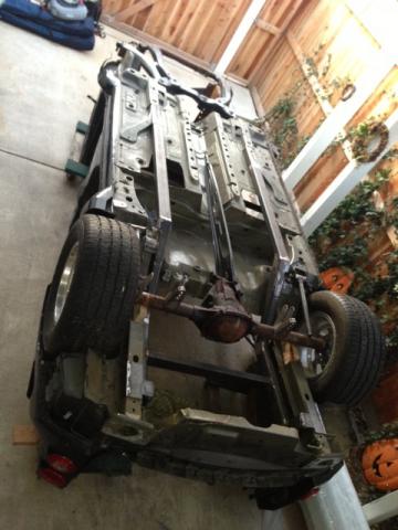

Well its one mock up after another. these tires are 27 1/2" tall (28" is about all you are going to get inside the wheel well) by 11" wide. I'm still looking as to how much tubbing needs to be done to get this much meat in. I hope I can do it without weakening the structure too much. I'll keep working on it. Anyway, that's what it looks like right now. I'll keep ya posted.

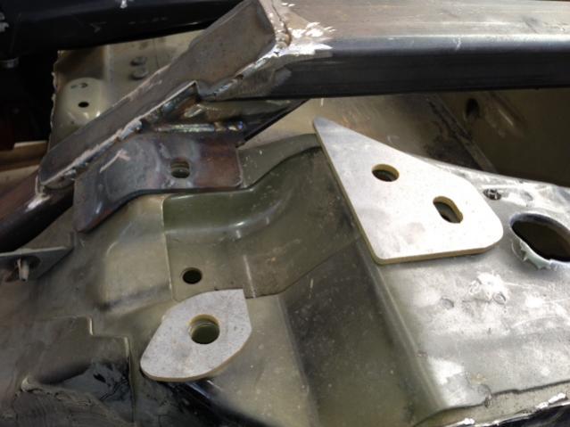

Here are some close up detail shots of how I built the rear suspension. the first pic is of the spacers that were cut to make up for the thickness of the rear suspension bracket. I chose to mount to the "hard mount" for the stock rear axle. It is the strongest place back in that area.

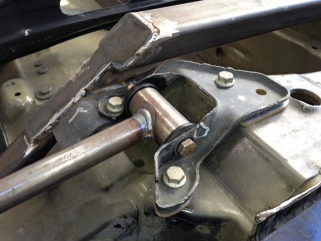

The second shot is of the rear trailing arms and how they mount to the body in the stock position.

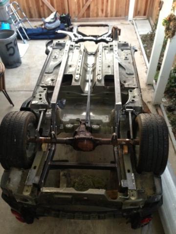

The third is an overall view of the rear suspension as it looks now. I still need to weld on the rear coil over mounting tabs and the trailing arm mounts to the rear axle.
