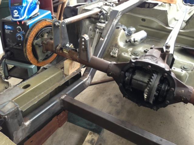

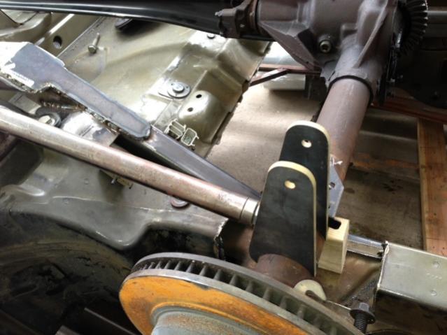

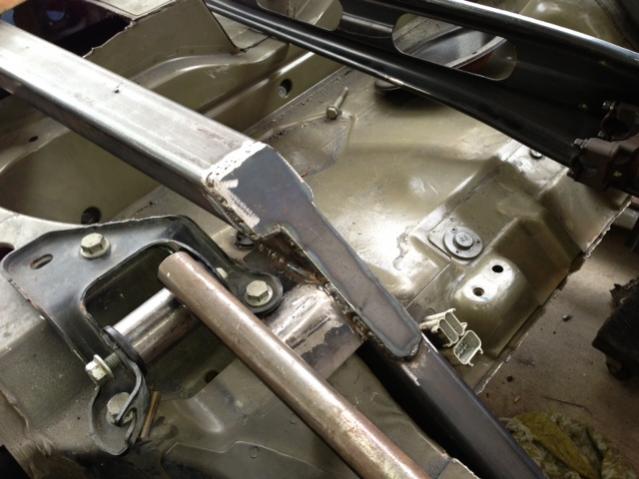

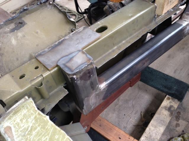

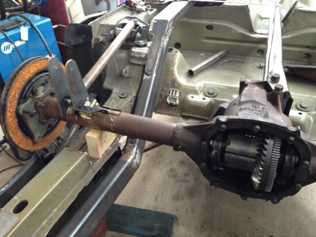

Spent the weekend working on the rear axle and suspension. I had some steel parts water jet cut and I started to install them. Mostly mounting brackets and reinforcing pieces. The RWD framing is mostly done now. Just about to fit mounting brackets for the coil overs and cut the rear trailing arms to length. I'm going to have to come up with something pretty trick for the panhard bar since my coil overs will be sitting right where it should go. I'll figure that out once the coil overs are set.

That's a pretty neat idea on the panhard bar. I think I'm going to have to go forward tho... I'm using up the fuel tank real estate quickly. Maybe I'm just over reacting. Sometimes things are not as crowded as it seems.

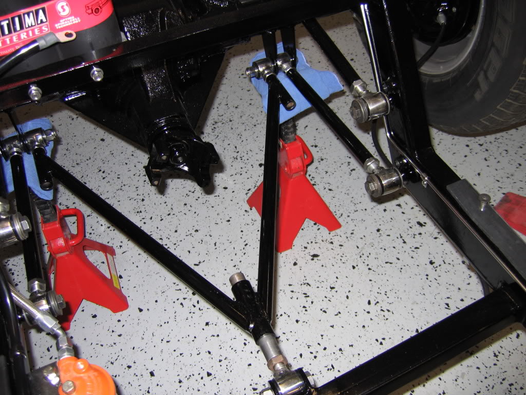

Have you considered an adjustable four link with a wishbone locator. It is an old drag racing system that allows the rear wheels to travel up and down in a perfectly vertical path whereas a panard bar has travel in a parrallogram path. The adjustable four link is in effect an adjustable traction bar. I have attached a couple of pictures of the system on one of my street rods.
