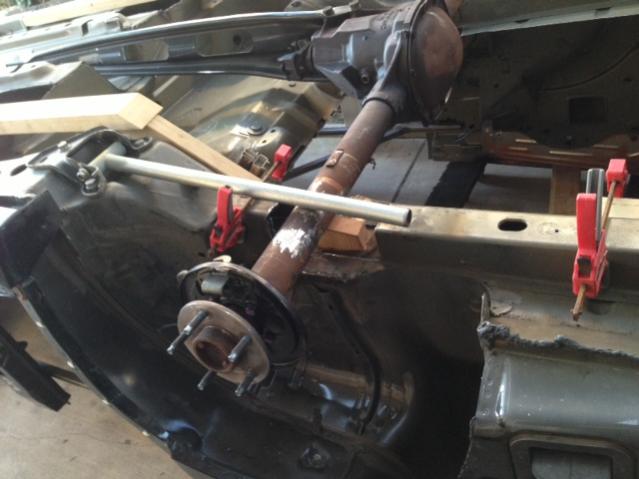

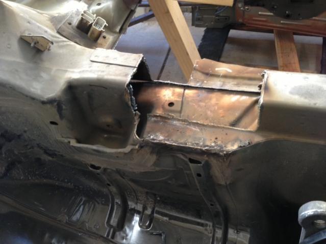

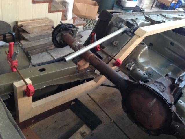

Begining Rear Suspension Mock-Up
Used the plasma cutter to start removing a bunch of metal around the rear axle today. Cut out quite a bit of metal to make room for the axle to move up and down. I decided on 1 1/2" x 3" rectangular tubing for the rwd conversion. I'm mocking it up from wood of that size. Once I get both sides done I can start on coil over shock mounts and trailing arm/panhard bar mounts. When it all fits I will duplicate the wood with metal. Still don't know about rear tires and wheels. I need to have more info on the wheel wells and weather or not I'm going to tub them and how much. I'd like to go with 255/55/17 on a 9 1/2" rim but I might need to go narrower. The problem with going with a really wide tire/wheel combination is the huge amount of metal that has to be removed from the car to fit them. Of course everything needs to be rebuilt and re-enforced when the cutting is done. I just keep thinking how cool it would be to light up a serious pair of meats in a HHR......
