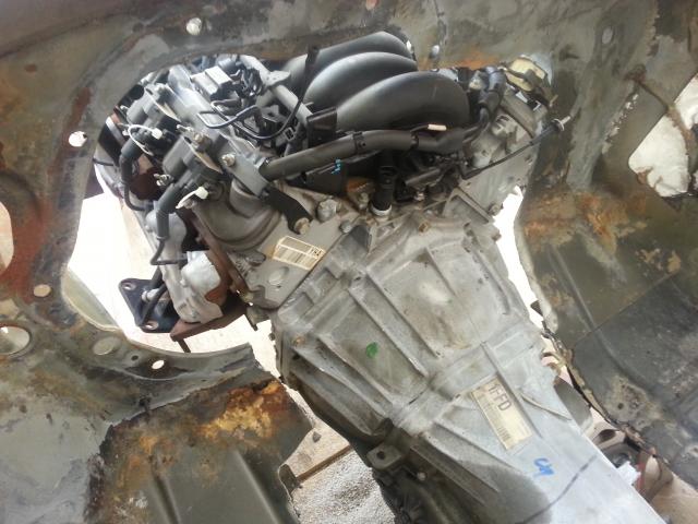

Some progress
Spent 2 full days working on the car; 1 day tearing out the previous motor mount install and the next actually making some progress. I discovered the LS1 rubber motor mounts were shot so I replaced them while I was in there. I fabbed new steel mount pads and extensions and welded them into the correct location. The correct location of the engine is determined by the steering rack location which must be fairly close to the center line of the steering arm spindle holes. I said all that to get to my next point.

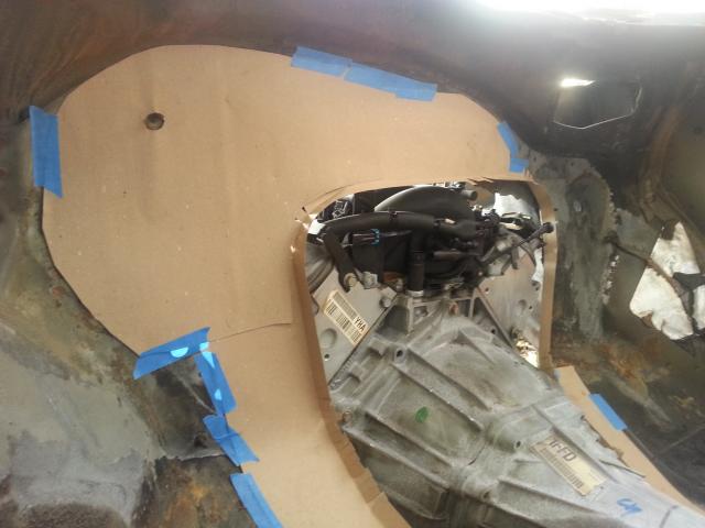

I had not planned on moving the firewall. That was before. I took the plasma cutter out and cut a hole in the firewall large enough for the engine to slide thru. I ended up moving the engine back almost 2 inches. This means in addition to the trans hump, I'll be fabbing a modified firewall....just as well tho, I have to move the master cylinder over to miss the engine.
The next item is to start making cardboard patterns for the firewall/trans hump. Once that's done it will be time for the bead roller and English wheel to transform it to sheet metal.
