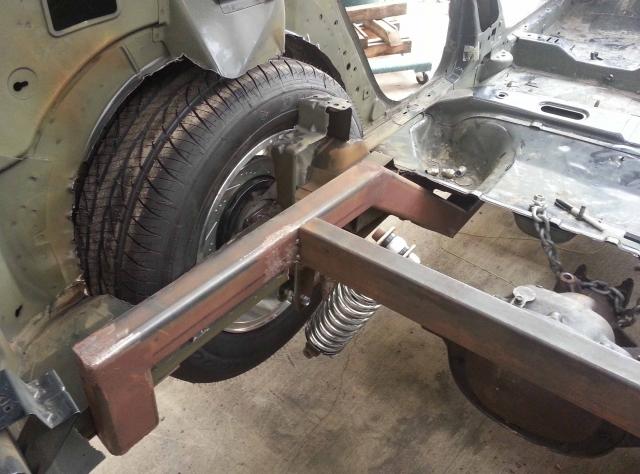

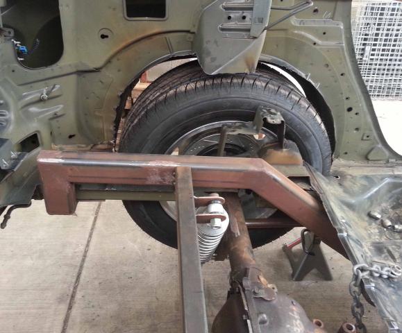

Well I spent the day flipping the mule right side up and re-installing the rear axle. I need to get both rear wheel bolted on the hubs and take a bunch more measurements. Once that is done I will begin on the panhard bar. I pretty much have in my head the design I'm going to use for it. I don't have a lot of room but I'm sure I can get it in. The shots show how much real estate the tires take up.

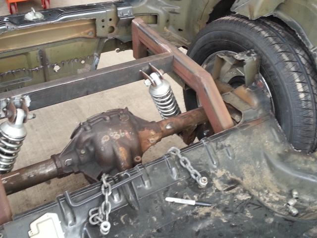

Here is another shot of the inside wheel wells. This shows how really tight the tire is inside the car. I'll get the plasma cutter out next weekend and clearance everything. A few spots rub as of now. Also have most of the parts of the panhard bar in now so that gets fabed next weekend. As soon as that is all done and assuming that it fits, I will be very close to setting it on it's rear weels for the first time.
