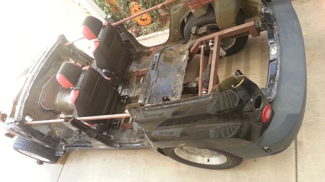

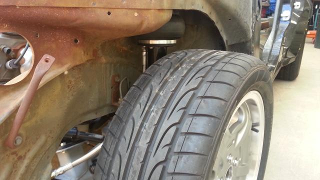

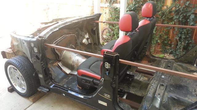

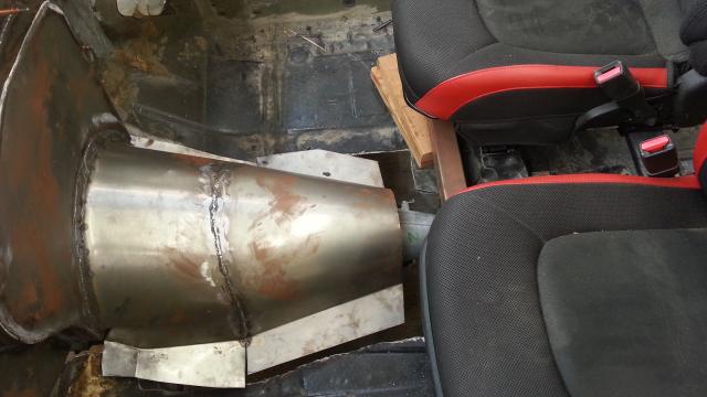

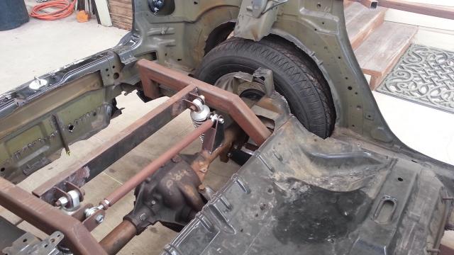

Almost done with Mule
The basic fabrication is coming along well. This weekend my nephew Greg and I installed the air struts on the front and got the rear axle in it's final location. I need to move the axle end of the panhard bar but I knew I would have to move it as I simply took a guess when I tacked it in before. No big deal. I also test fit the SS front seats in the car to make sure the trans hump leaves enough clearance for the seats to move back and forth. No problem...there is lots of room. It wont be long before I will have learned all I can from the mule and I can get serious on this conversion on a whole car.
