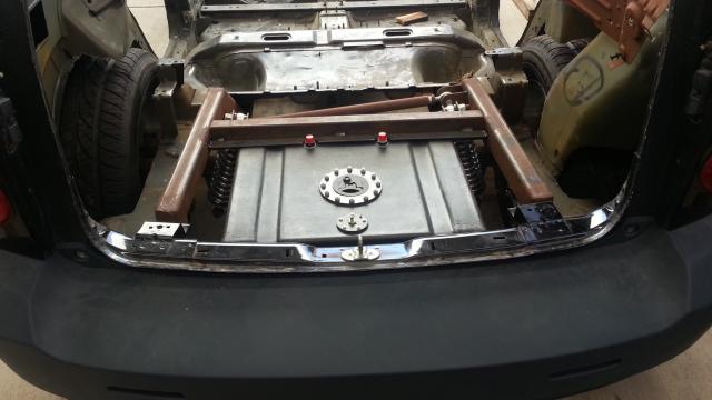

OK maybe 1 picture
Here is the fuel cell installed.

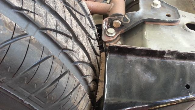

We Have Clearance, Clarance
For the first time I actually have enough clearance around the rear tires for them to actually turn! I have about 1/2" in the front and rear on the wells. This is about all the rubber that is possible in the rear of an HHR without COMPLETLY cutting the crap out of the wheel wells which would involve cutting the bottom rear section of the rear doors and reshaping the rear bumper.

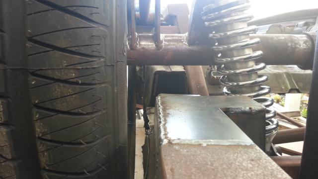

Old Oct 20, 2013 | 10:39 PM
  #210
lasater's Avatar
Joined: 04-06-2010
Posts: 655
From: Riverside, California

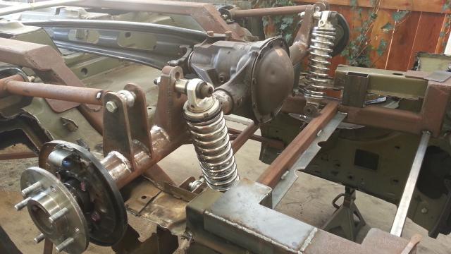

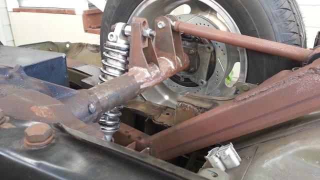

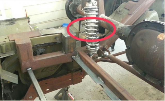

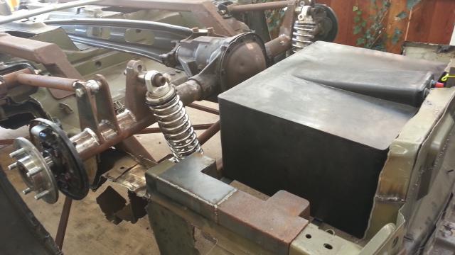

Good News
I wasn't able to tell if I needed to cut a giant chunk out of the rear frame rail sections of the body until now. I have the rwd almost completely finished now and I can see that i don't need to notch the crap out of the body. This is really good news as it is a major structural area of the body. In this first photo I put a red circle around the area I'm talking about. The rest of the pics are just where I am at this point on the build.
