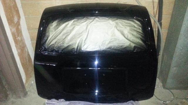

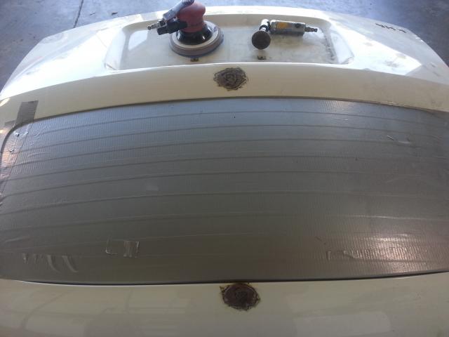

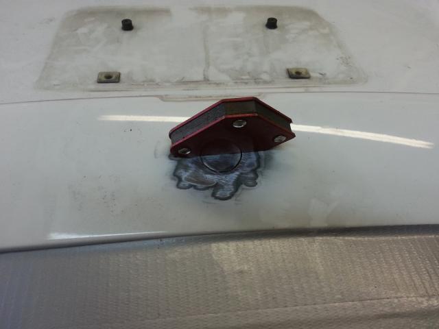

Correct way to fill rear wiper hole
Since I have to do everything anyway, I'm filling in the rear wiper, rear washer and radio antenna holes. I'm welding in sheet metal plugs, grinding the welds and finishing it off with bondo. The rear door is repainted now and it's perfect.

Duct-Tape has many many uses lol! Its gonna suck getting all the stickyness off that glass, either way lookin good!!
