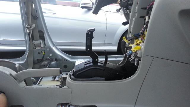

B&M Shifter Placement
OK so I'm playing with the placement of the shifter. It's a B&M Pro Ratchet model. If I place it on the top of the stock console it is too tall. I'll have to build a internal support for it and then I'll have to section the plastic housing and build a new top cap. I have it sitting in some rolls of masking tape in this photo and I am liking the height of it. The grip location seems just about right.
Old Nov 15, 2013 | 07:47 PM
  #233
Posts: 40,083
Nice work, thought and attention to all the details!!! very cool pistol grip shifter

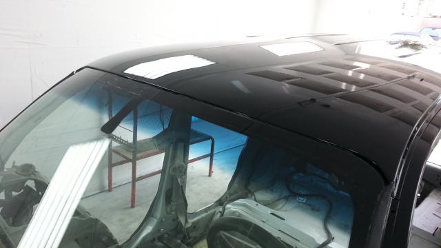

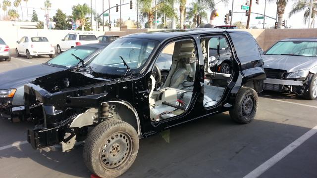

It's Painted
Saturday we rolled it into the booth and shot it black. The thing I like best about it is the removal of the radio antenna. For some reason that roof mounted antenna always bugged me. Too European or something. Anyway, it's gone.
