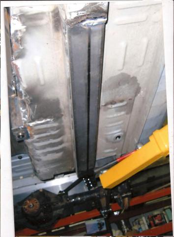

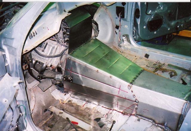

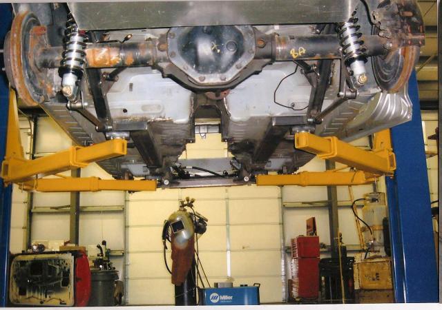

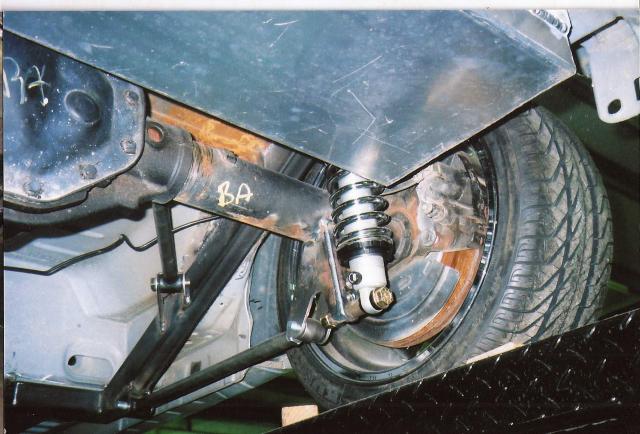

In my research for this project I have been in contact with Terry Beaty of Cleveland, Tenn. He owns the best example of a V8 powered PT Cruiser that I have seen. He has been very helpfull in this. I have had my HHR up on a rack beside a PT Cruiser to compare them. Altho the PT has a slightly flatter floor than the HHR it will be possible to build the same setup he has for the RWD. Ill show you what the plan is:
These are the rear trailing arms/floor supports
This is the plan.

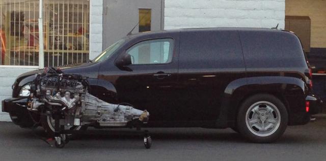

LS1 with Panel
I set the engine/trans next to the panel today to get an idea of just how much room it will be taking up. It's gonna be cool. First step is to get the rear axle and suspension in the mule, then I'll work on the engine compartment. I hope to begin over Christmas, time permitting.

The engine and tranny look gigantic!

That should be HOT not cool at your feet lol. Seriously though that will be very cool once you are done and should be a fun project albeit a very labor intensive one. Are you planning to leave room for future access to the rear cylinders? I noticed on that PT the rear cylinders were next to the gas pedal area but that is that stupid cab forward design so ours may not have so much of that problem. Or should I say were in the spot where the gas pedal normally would be lol. Also do you think you will be able to get enough thermal blocking materials in there to keep the heat out of the foot area?
