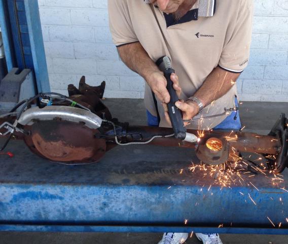

Actual Work Begins
First order of business; I am using a plasma cutter to remove all of the brackets and tabs on the Camaro rear axle. This is the first step in setting it in the HHR mule. All new brackets will be fabricated for the coil-overs and panhard bar.

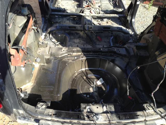

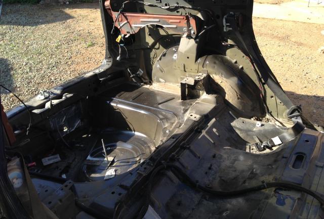

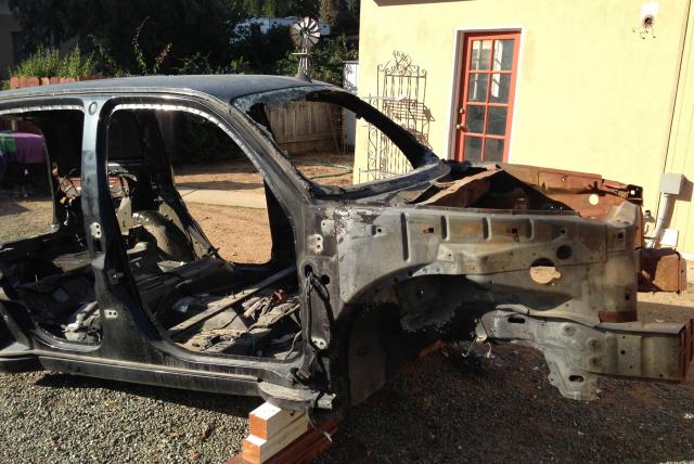

Here's the Mule
I located a 2010 body that had burned...sort of a rare thing in my opinion. Almost all HHR wrecks are hit on one of the corners enough to throw everything out of whack. This one is really straight. I'll get the burned/rusted areas sand blasted and then take a spray can to the area to keep it from rusting again.
