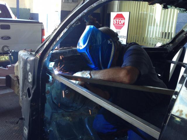

Make sure before you cut that roof/top off you Brace all the door jambs up like this.
Once you cut the top off the body may become flimsy. You want the main body Locked in place, so your pre fab work and measurements are correct.
You turn it over and the HHR body flexes out of place by 1/4-1/2" or alot more, everything will be off when you go to transfer all your custom parts to the real car.
You want to Keep everything Straight and True. The cars boby (unibody) is built like a box to keep it rigid, once you cut one side off (the top) it becomes flimsy and can easily flex alot. Be careful.

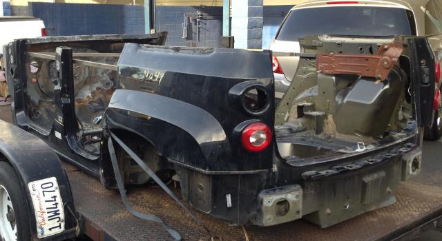

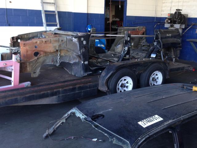

Cutting Top Off
Here are some shots of the cross bracing being welded in and the top off the car. It really don't look bad with the top off. Has anyone ever considered building a phaeton???
