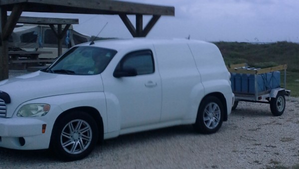

HHR Camp Setup
My setup works fine with the skeeter beater screens and a fan inside. Sleep on a twin air mattress with the passenger seat pushed forward and a cooler behind the seat for support The trailer is a 40" x 48" aluminum hauling 1000#

My point was the 4 bolts that hold the hitch to the car through 10 gauge sheet metal. If one of them should self loosen a disaster is pending.
The tongue weight is like 100Lb. From here yours looks kind of wallowing. When that happens the front end raises up and the front wheels camber inward, making for odd traction, handling and tire wear.
I'm just a cautious guy.

Assume you are posting to Ben. I am a retired Maintenance guy in the oil industry and check all my bolts on trailer/hitch for tightness before and after every use. My load is also balanced and 20# under the recommended load rating, which I know has an engineered safety factor.
I would definitely monitor my transmission temps and wheel bearing temperatures and consider lowering speeds according to those numbers. Sound like Ben is looking at alternatives.
