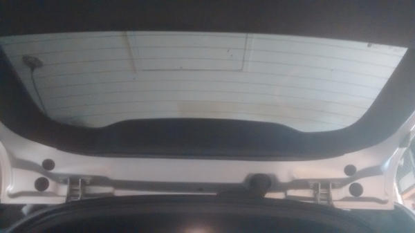

This is what you see sitting on the ground, facing the rear of the vehicle, looking up at the open hatch. You see the 4 rubber plugs, the upper ones are covering the access holes. You'll need a 10mm nutdriver or socket. Check to see if you need the rubber plugs for your car also, some apparently are not drilled for it.

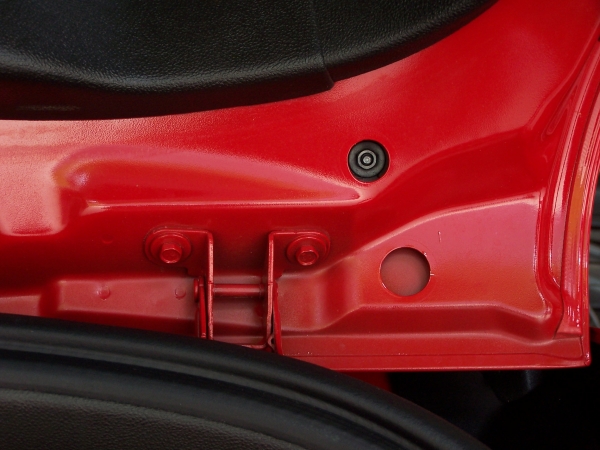

This might help. Shows the outer right side stud/nut.
