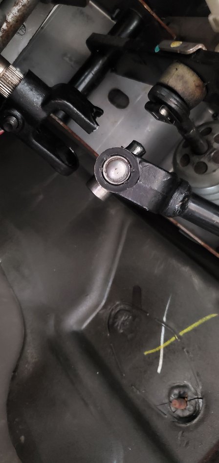

1st of, we are ok. Everyone freaks out when I tell them the intermediate steering shaft broke.
It broke when I put it in reverse to leave a parking spot.
sooooooo..... the steering wheel is not going to be straight at all, how would i go back to a true steering wheel? I have a new Dorman shaft coming. But between the tow truck and turning the steering wheel, I have no clue where center is now.

Get the front wheel straight ahead, Then the steering wheel centered. Then install the shaft.
if the steering wheel has been spun will-nilly the chances are good that the clock spring is broken. I guess the best way to center it would be to turn GENTLY it in one direction until there is any resistance \then in the other counting revolutions, divide by 2 that is centered. Might be a good idea to have someone that knows how to use a diagnostic computer to recalibrate the sensor.

Soooooo if anyone needs to know, it's 6 full rotations from right to left. So dead center is 3 rotations.
Plus mine still had green factory mark on steering wheel side.
