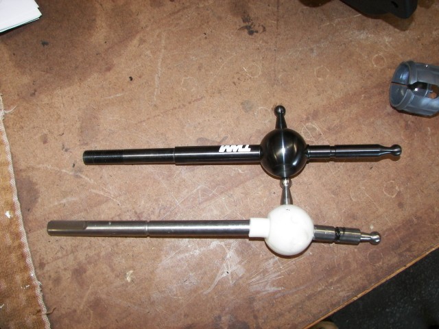

Compare the TWM to the stock shifter
The top shifter is the TWM shifter and the the bottom one is the stock one.
If you notice the ball of the TWM is higher changing the pivot point and making the throw shorter.
https://www.chevyhhr.net/forums/atta...1&d=1224381957
Old Oct 19, 2008 | 06:27 PM
jonathanm's Avatar
Joined: 08-26-2008
Posts: 24
From: SC
How does the SS shifter compare?
I would love to see this picture with all three side by side.
