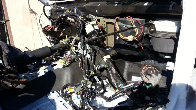

Yikes! what a mess
I spent the day tearing the harness out of the Camaro. Wires everywhere.

So now it's kind of like a Cahhro ???
Very nice work, by the way!!!

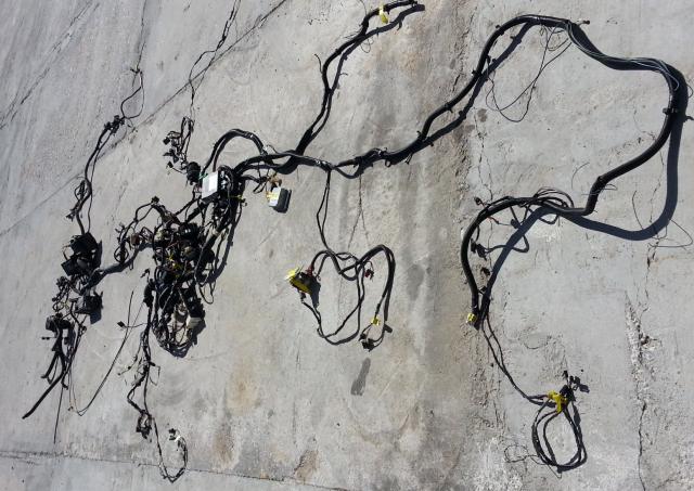

Camaro Harness
Here is the Camaro harness out and on the ground. It took 2 days to remove it. I have every wire and connector, every part of the system. I also took out the gas pedal, shifter, complete steering column, BCU and ECM. Now all I gotta do is figure out how what I need and what I don't need.

Originally Posted by baldrodder
If you want to simplify the engine/trans wiring you should give Kevin a call at Crazy Diamond Performance (Shelby Twp, Michigan) 586-884-6935, http://www.crazydiamondperformance.com . They have a wiring harness for the LS's that's essentially a 2 or 3 wire hookup, and you can keep On-Star, traction control and tons of other options! It's very slick and made in the USA by disabled vets!
I talked with Kevin at Crazy Diamond. He is a VERY knowledgable guy and was intrigued with my project. We talked a while and it came down to this; the Ls1 can't communicate with the BCM on the HHR. The electronic language is different between an '08 HHR and an '01 Camaro. I have 2 choices, run the Ls1/ 4L60e I have with the Camaro harness OR.... Install a Gen 4 engine/ trans combo in the car and he thought that they could make it work with a custom wiring job. Financially the second option ain't gonna fly. It would be at least 12 grand. And even then it wouldn't pass California smog. So it's onward with the splicing of the Camaro harness into the panel.
On Tuesday I'm meeting with my buddy at the local Chevy dealership and he is going to print out the electrical schematic for the Camaro. Then it will be some time spent with a lot of schematics trying to figure it out. What goes, what stays, what splices to what.
Anyway thanks for the recommendation to call Crazy Diamond. They seem like a knowledgable and friendly place to do business with.
All I can say is Damnnnnnnnnnnnnnn,, I cannt wait to see her done :)
