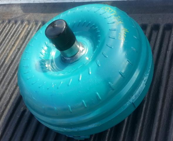

Torque Converter
As the work continues on the cut out areas for the cats, I received my new, new torque converter yesterday. I say new, new because this the second one I got. The first TC was a 2200 stall speed unit. I had to exchange it because the cam requires at least 2500 stall. This TC is a modified Chevy Equinox unit. The cam that I have for the ls1 is a Comp Cam Mutha Thumpr series 601. This is about all the cam you can get and still drive it on the street with no problems. It should sound really mean, especially at idle. Of course the cam includes all the rest of the kit from Comp, roller lifters, magnum push rods, needle bearing roller rockers, dual valve springs and timing chain and gears.
