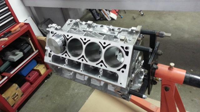

The Ls1 is finally back from the machine shop. It was machined in every possible way. Including the decks being squared with the center line of the crank. Most of the new parts are laid out on the bench. The best of everything. Ls1's routinely make over 500 hp but it isn't easy or cheap to build them that way. On Monday I will get the 102mm throttle body
(Z28 Camaros come with a 78mm) and mount it to the FAST 102 intake manifold. It should be real nice.
