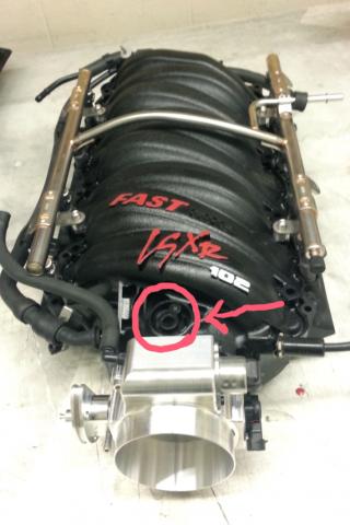

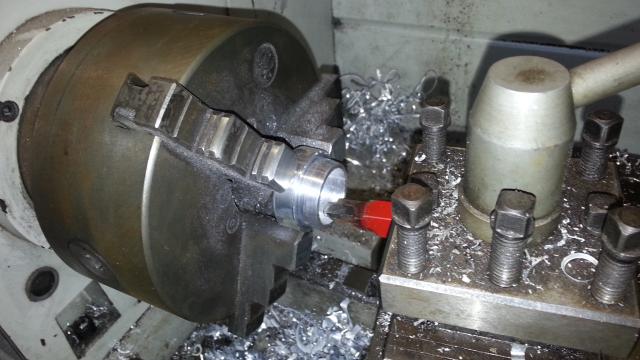

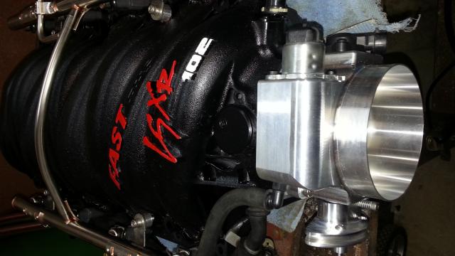

The FAST 102 intake manifold that I have is made to fit the Ls1, Ls2 and Ls6 engines of various years and displacements. Because of this there are mounting spots for sensors in several locations. Depending on your engine you may or may not use each location. My engine does not use the spot dead center just behind the throttle body. Unfortunately, to me it is a real eye sore right at the main focal point of the engine. To this end I have spent almost all day fixing this. I chucked up a hunk of aluminum and turned a cap that is held down by a counter sunk metric screw and painted the same color of the manifold. This makes the extra mounting spot almost invisible. Here are a few shots of the process.
