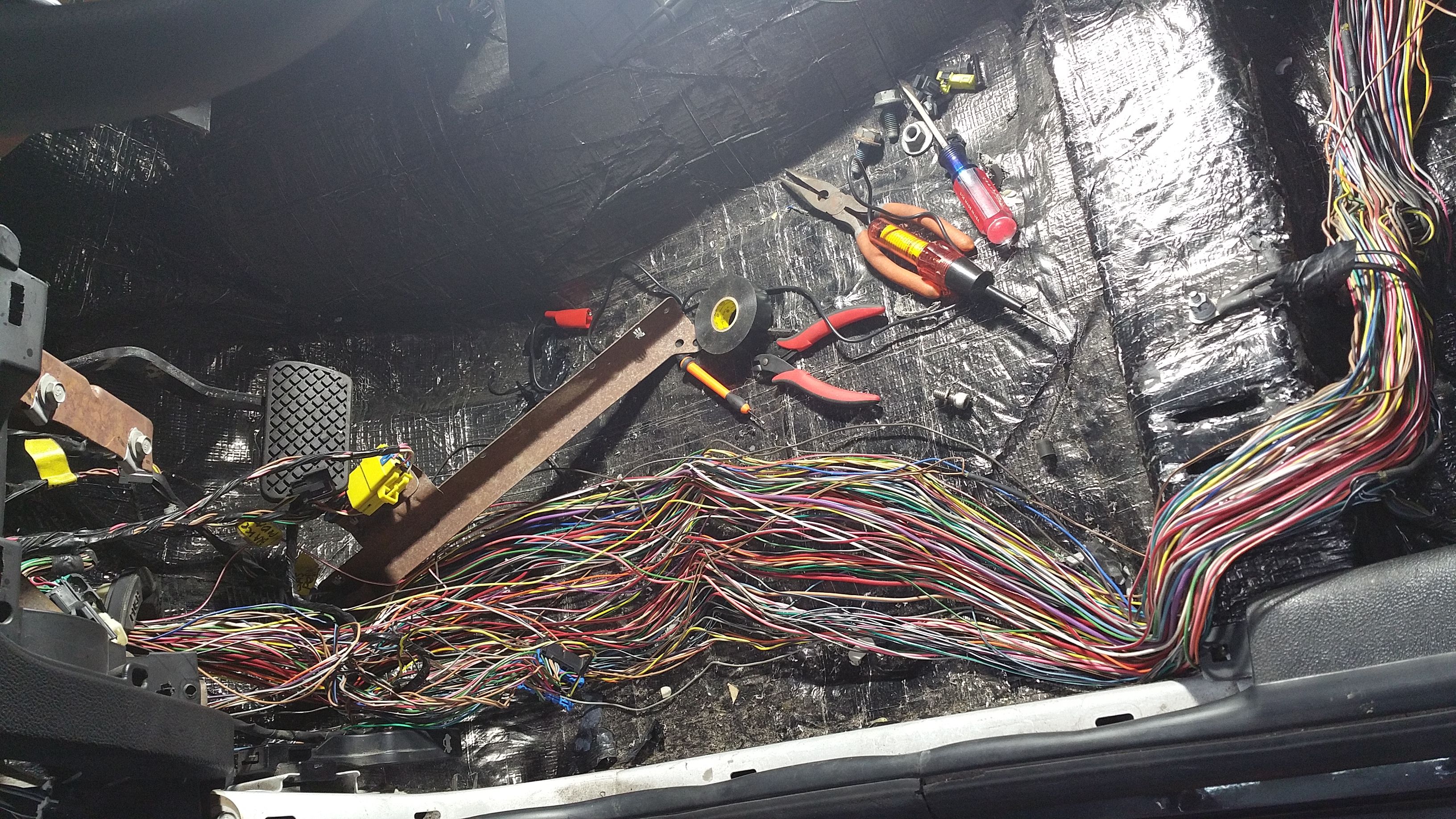

Wiring Harness
It's not just the engine compartment wires, I'm completely removing the unused wires all the way back. Im working on the "low fuel warning light right now. Of course it goes almost bumper to bumper.

that's about as much wire in a telephone control room, good luck

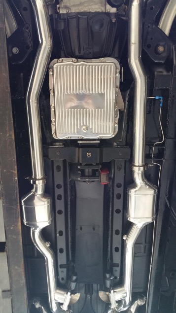

Ceramic Coating Done
As the tracing, removal, cutting, splicing, lengthening, shrink tubing and bundling of the wiring continues at a snail's pace, the exhaust system got back from the coaters. It came out pretty sweet. It won't rust and it will keep the heat inside the tubes a little better.. I also mounted the QuickTime low profile cutouts. Something else to wire in.

Aye the pipes! Soon they'll be calling!! Hopefully way before next St. Patrick's day.

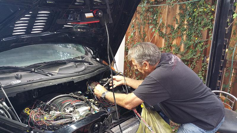

Wiring Harness Mods
Soldering away, straightening things out. It is a ton of work just to mone the fuse block to to other side of the engine compartment. Im working on connector X2 here.
