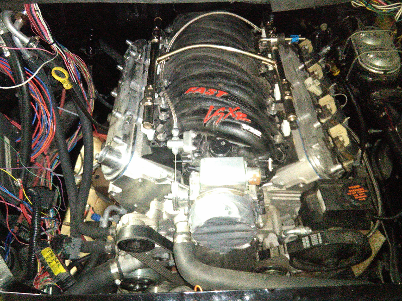

No more wiring harness!
This engine is SNUG in there. Sneaking the harness around took a little time. All for the better though. What engine bay isn't happier when it's got a fresh 400+HP heart?

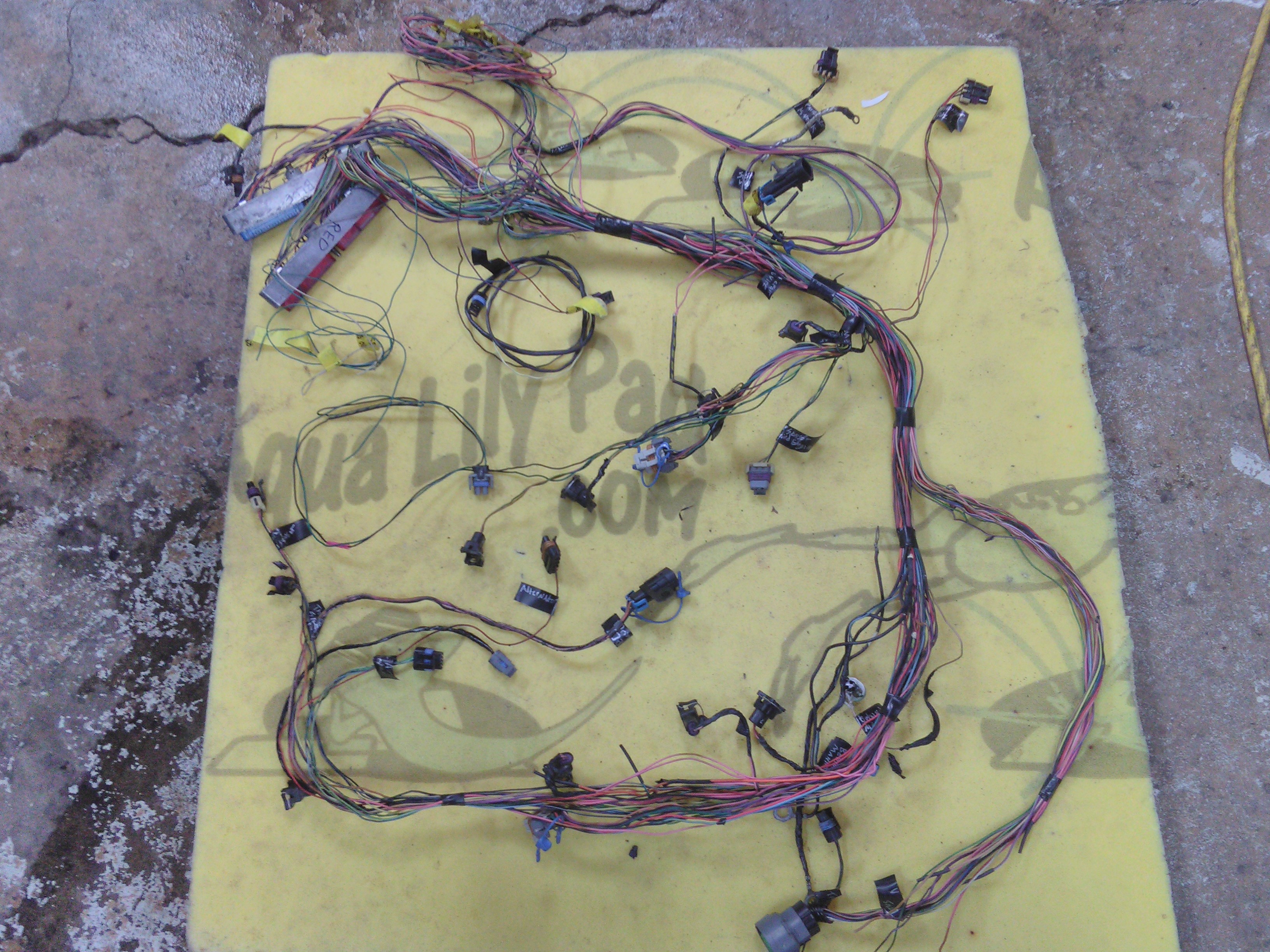

The harness all out of the car...

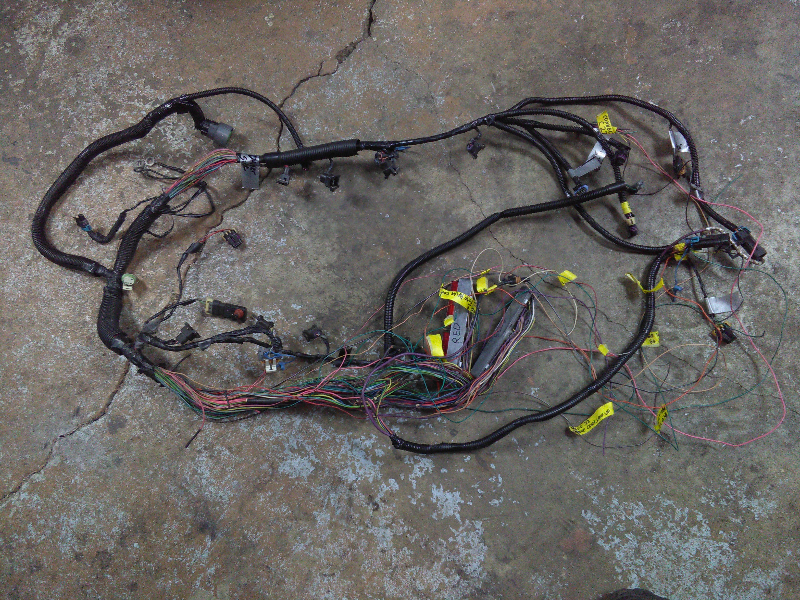

Begin the choppy, choppy! I did this to the LSx Sorento but with a harness I bought brand new from GmPartsNow.com although it was worth the $200. Fresh electrical tape comes off sooo much easier then the continually re-heated stuff does...

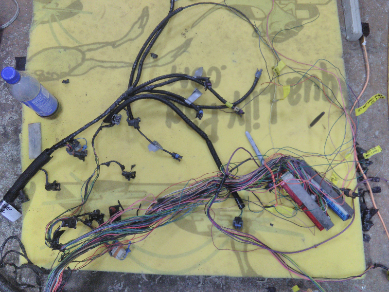

Finally a naked harness....
My super fantastic wife bought me a really nice X-Acto knife.... It helped get that nasty old GM electrical tape off the harness. That stuff I'd wrapped every which way I swear.
Now to totally de-pin the harness....
