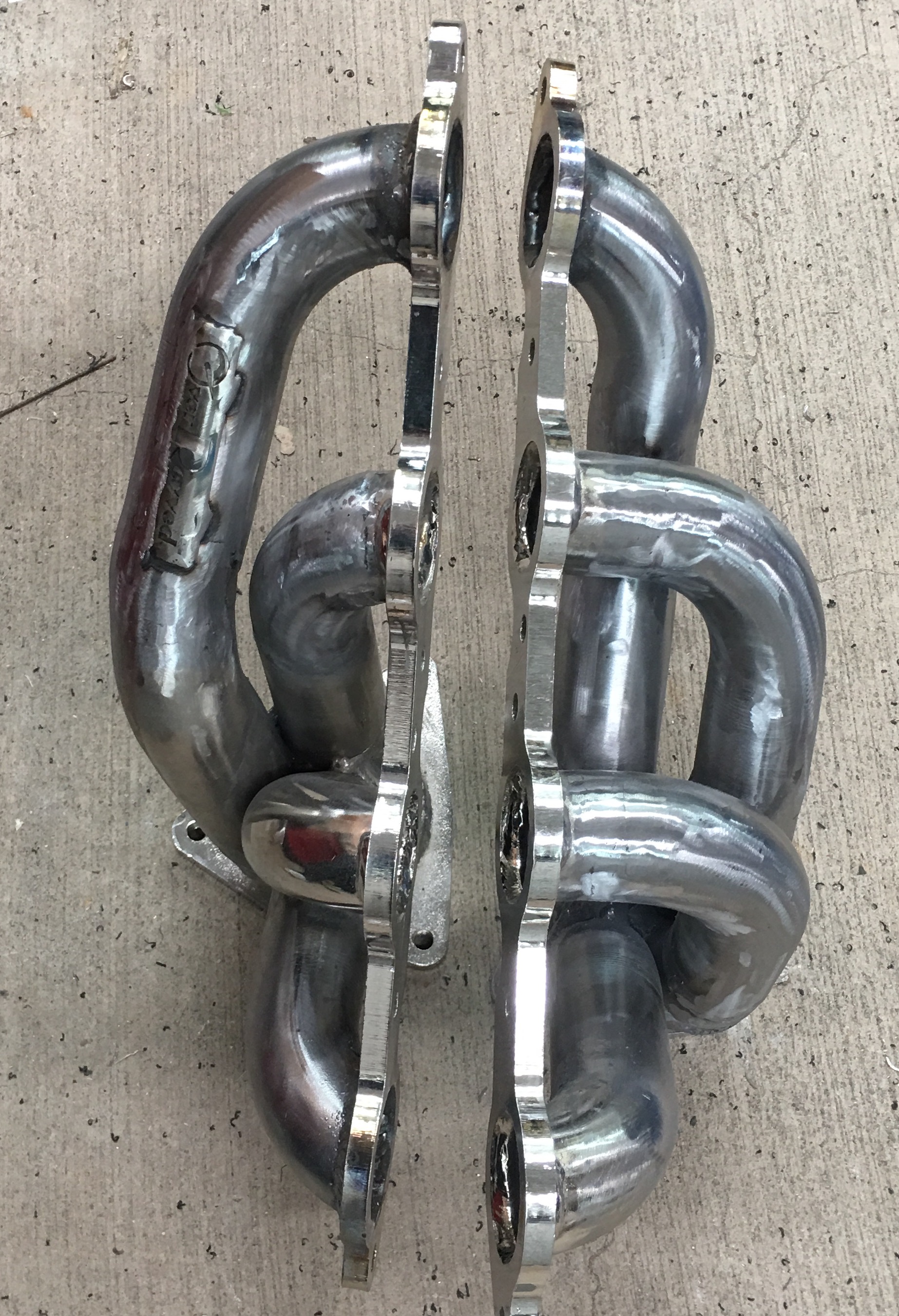

Craig Gibson built some custom headers for the car. I just finished up some clean up on them and they go to the ceramic coaters tomorrow. When the coating is complete I'll ship them back to him in Ohio. He completely revamped the exhaust system and added some ponies. It's gonna be nice.

Ahh the pipes, laddie, the pipes!!

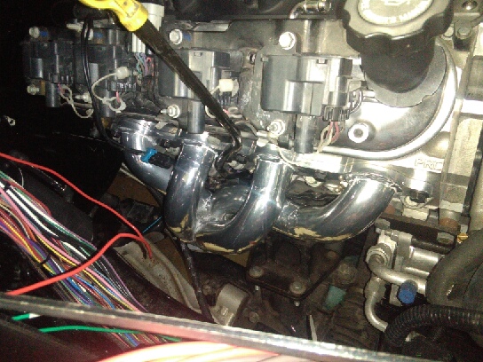

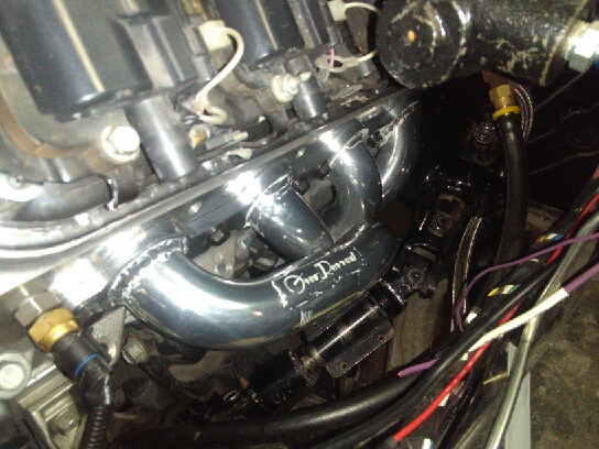

Craig Gibson's custom built headers got the ceramic jet coating and they look great. They are installed now and they clear all the obstacles around them. Both banks had some serious issues for fitting correctly but now they work great.
The PRC heads I'm using, coupled with the 102 mm throttle body and matching intake manifold and the gigantic cam really need these headers.
lasater is offline

I am glad you let me talk you into going with headers. The factory Ls1 manifolds are a serious bottleneck. I am actually surprised at how much of a difference it is between the Ls1 and the 4th gen manifolds I have here. The one pair is from a 5.3L and the Ls1's are smaller then even they are.
The other major benefit is that now the passenger side outlet is where it needs to be rather then where they were before, as dictated by the manifold's outlet options. This gets rid of the very sharp S bends that were in the exhaust piping, of which there really was no way around without the custom headers.
