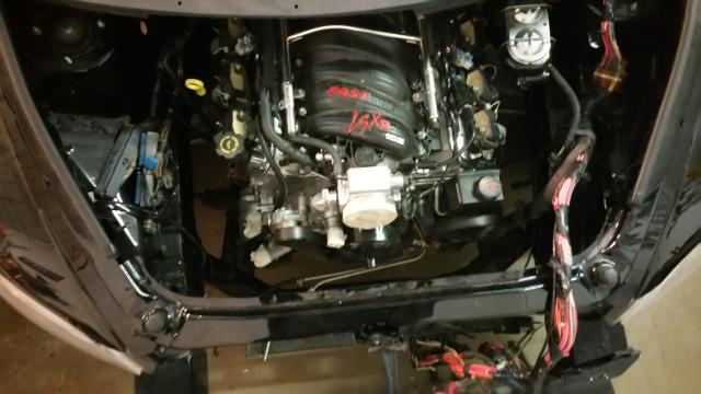

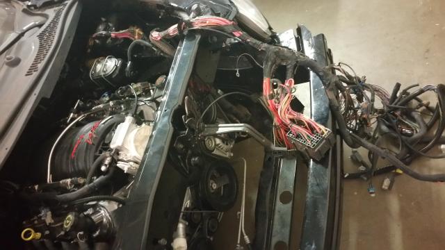

Since the V8 project is at my buddies shop getting the wiring sorted out, I'm going to begin on the roll cage. The cage needs to fit inside a stock interior so I will be building it to my daily driver. I'll be using 1 3/4" mild steel tubing , a JD Square bender and modified Harbor Freight tubing notcher.

If you need any assistance with the engine ECU wiring and "How & What" to connect up and programming, please let me know - Happy to help out. You've prob got the same LS1 engine ECU as what's in my '56 Coupe..
I'm getting ready to email for associate re programming my C5 for some deletes & power tune her, and plus the coming up HHR conversion. I'll will be asking re the Comm between the different Engine ECU and the HHR BCM, which for the instrument panel - isn't a lot of data transfer. I do have all of my old notes and plenty of Electrical schematics on the HHR and 2001 LS1 ECU
WE were very careful with the Mod's and programming the changes and deletes. Started the first Crank and No Codes. I do wish that I had retained the Charcoal canister purge solenoid.
