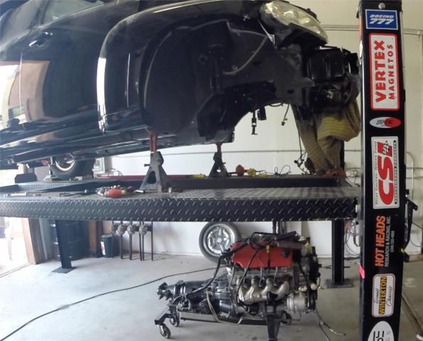

Since their doesn't seem to be any interest in a "how to" on a roll cage I thought I would continue with the time lapse video of the engine install. I'm working on it in iMovie right now and here is a teaser frame of what it will look like.

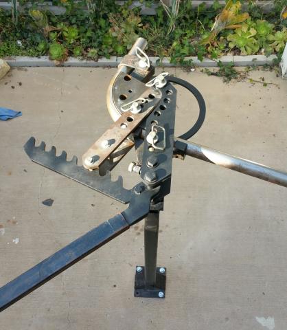

HHR Roll Cage 101
Ok, today I began on the roll cage. ....well, getting ready to build it. I haven't used my JD2 bender in over 10 years and I ended up spending an entire day setting it up. I knew I had all the correct parts but I just couldn't remember the correct way to assemble it. It goes together only 1 way. It's a real puzzle.
Anyway, I got the first test 90 degree bend complete. The next step is to make a special angle finder and start making a full scale cardboard template of the shapes. I'll get back to it in a few days.
Here is a shot of the bend.

Anchored to the concrete, nice. Permanent patio furniture now?

I'm glad that I'm not the only guy with a tubing bender that has left it sit long enough to require a period of head scratching and "umm..how's this thing work again?".
You've gotta anchor those suckers to the concrete Xtreme, thought I was "smart" back in the '90's when I anchored my old heavy duty tubing bender to a steel workbench with the thought of "that ain't going nowhere".
Halfway through bend #1, I moved the whole 4' x 10' bench loaded with tools, and a Powerglide transmission.
Back to O.T.
What wall thickness tubing are you using laseter, NHRA spec, or more for "just in case it gets away from me" spec?

I'm using 1 3/4 x .118 mild steel. I'm not really concerned so much about NHRA spec, as I am trying to strengthen the chassis. I just don't want this sucker to torque twist too much when I stand on it. I will feel pretty stupid if I find out the hard way that I under - engineered this car. With the amount of metal I have cut out of this chassis and the amount of horsepower I'm putting in, I don't think I can make it too strong.
