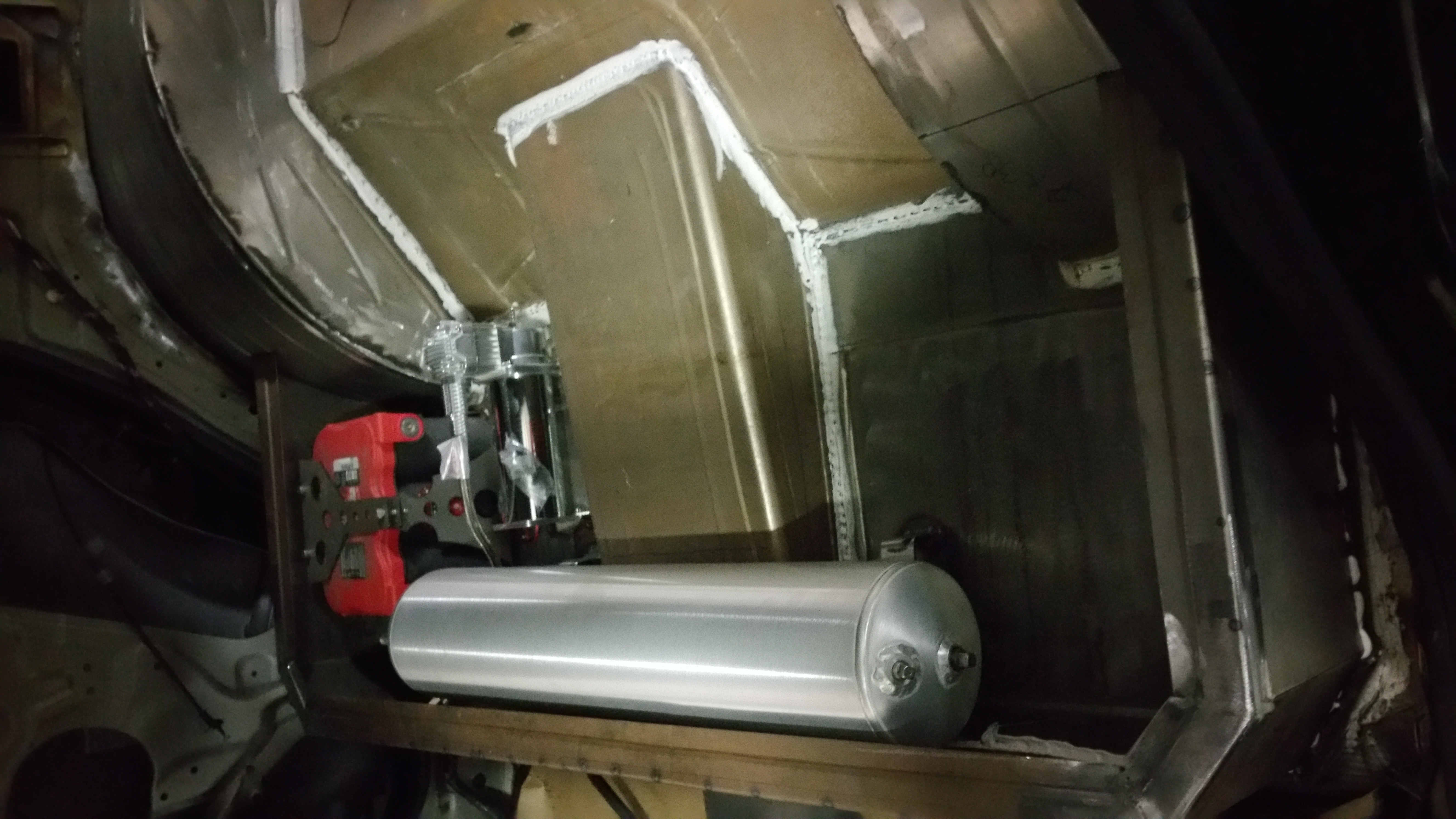

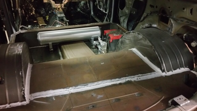

Old Jun 23, 2015 | 05:38 PM
  #577
lasater's Avatar
Joined: 04-06-2010
Posts: 655
From: Riverside, California
A little progress
The mounting feet for the air tank are finished and the battery hold down is welded in. The compressor is sitting just about where it will go. Slowly, piece by piece.
