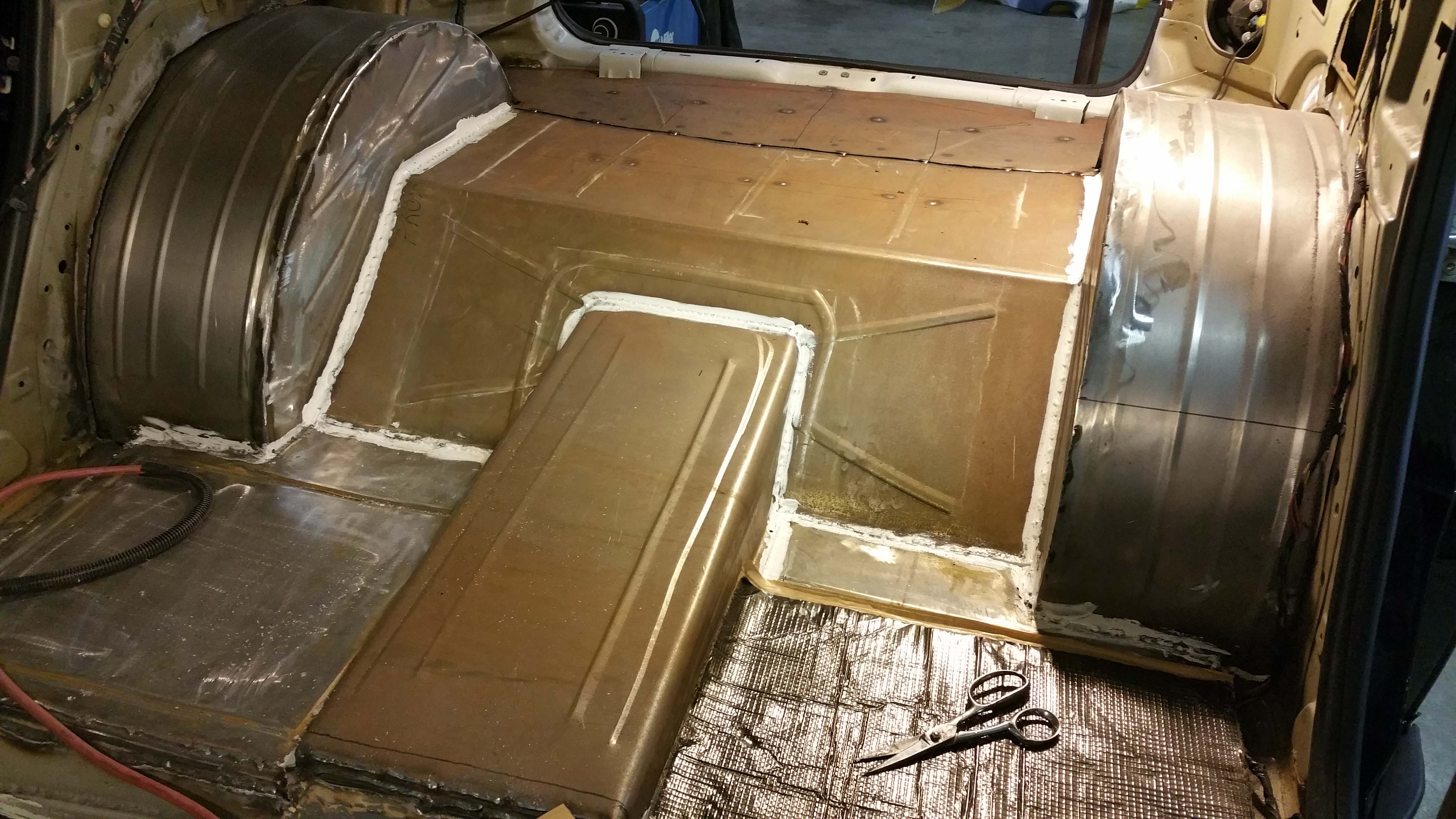

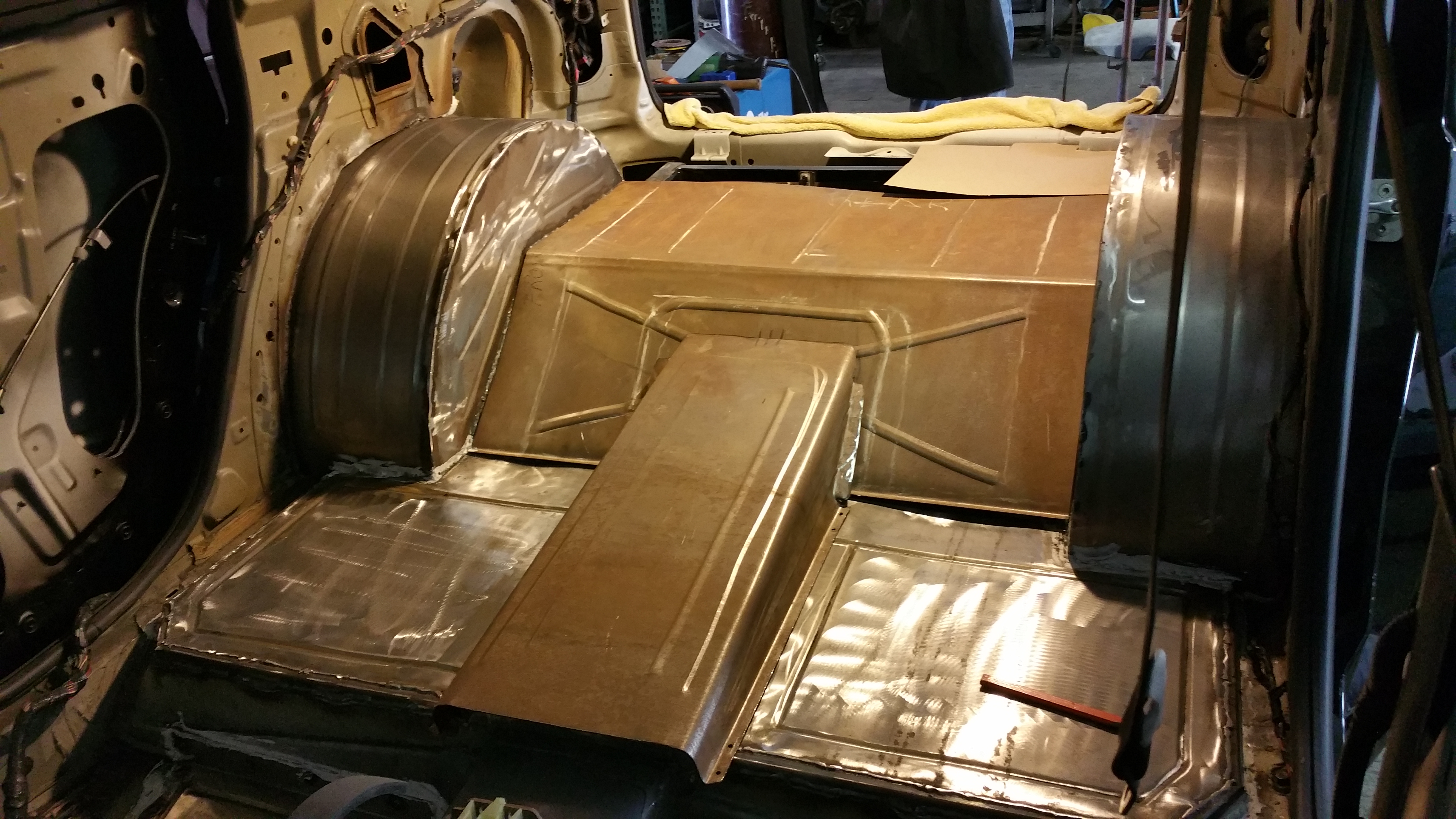

Rear drive shaft / tubs / floor
The sheet metal in nearly complete in the car. All the pieces are coming together nicely. More welding is required but that's easy. At this point I don't know if the stock tool box will be modified and put in or a new tool box will be fabricated. The way it's looking is the cutouts for the rear tubs are so large it doesn't leave much of the tool box doors, so it might be easier to just make one. I need the tool box because the battery and air compressor go on the passenger side and the air tank goes on the driver side.

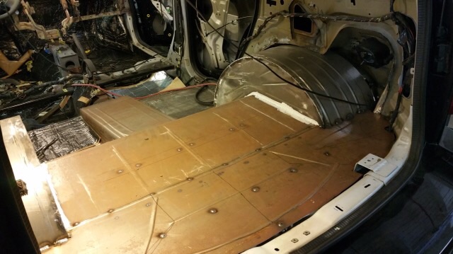

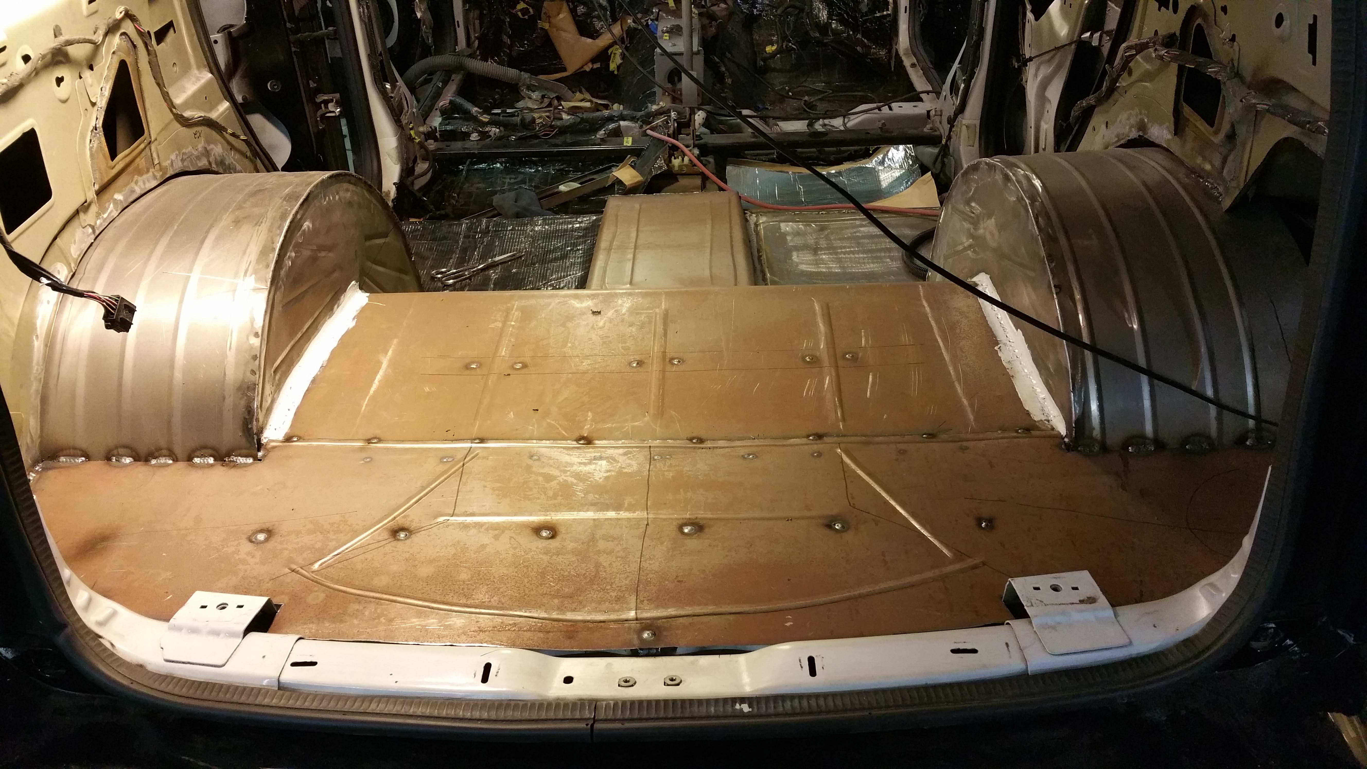

Rear floor complete
All the welding and sheet metal is finished in the rear of the car. The next thing is to build the "tool box" area. It will have a single access door instead of the two doors that the stock tool box has. I ordered a 4 gallon aluminum air tank (6" x 30") to fit sideways inside the box. The battery will go on one side and the air compressor will go on the other. It's starting to get exciting.

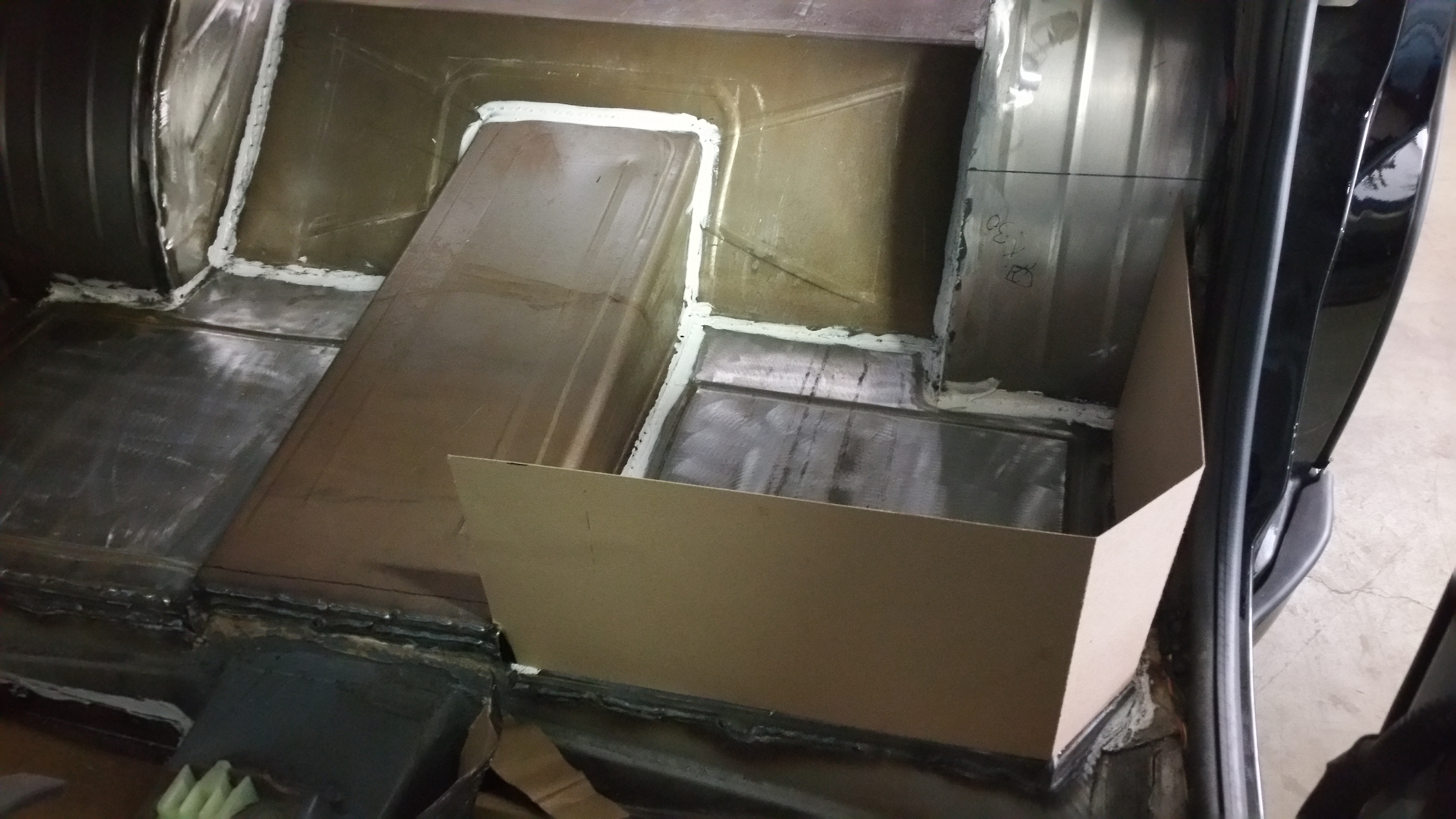

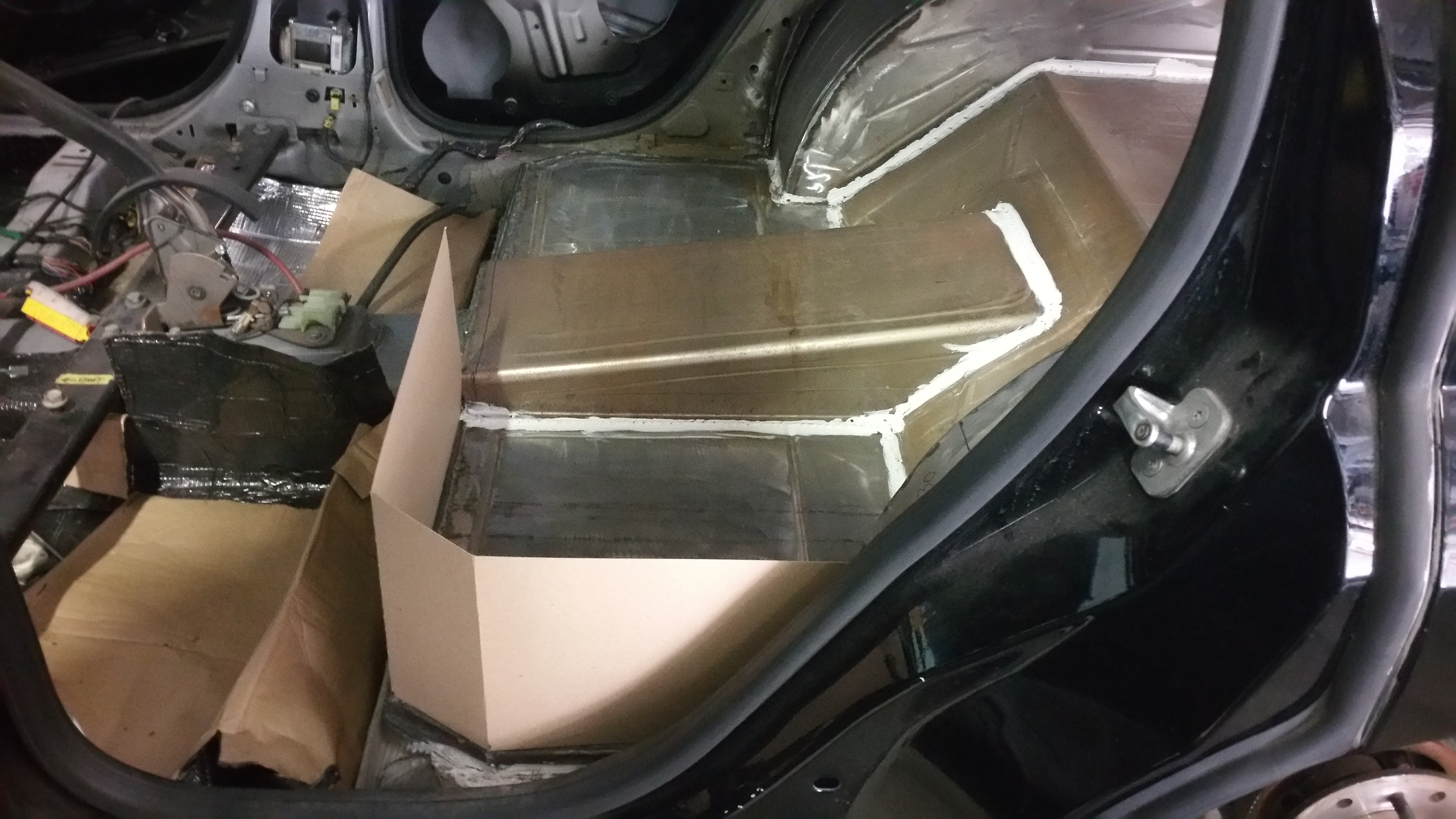

Tool Box Mock-Up
The floor is complete and work begins on the tool box. The cardboard template shows the shape. It's 9" tall, very close to the stock box. The single door will have 2 gas filled shocks to support it.
